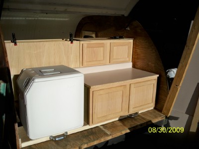

Postby hoosierteardropmaker » Sun Mar 14, 2010 9:44 am
I built my galley as a removable, slide out. I like the fact that I can use the trailer to haul things if i take out the galley. Plus it makes cleaning out the trailer a cinch. I did use heavier cross members between the sides for added strength and so far it works great. There are pics in my album , have not figured out how to add them here yet. :applause: [/url]

picture of removable galley
Postby hoosierteardropmaker » Sun Mar 14, 2010 9:53 am
here is a picture of the galley that i built as slide out.
hope this works.
http://tnttt.com/album_ ... c_id=54821[/url]

removable slide out galley
Postby hoosierteardropmaker » Sun Mar 14, 2010 9:58 am
one last Pic attempt. Sorry i am just learning the ropes on pictures.
Notice the built in handles on front of unit.
