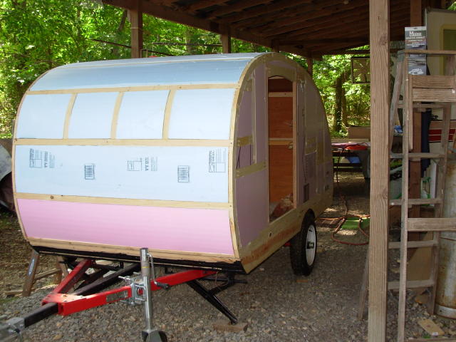

Postby Nobody » Tue Aug 10, 2010 9:12 am
When I built my TD in 2006 I had no problem finding appropriate thicknesses of 'closed cell' foam board locally. We have a large HD within 3mi & a new Lowes approx 6mi away. Both had a selection of the pink (Owens-Corning) & blue (Dow) from 1/2" to 1 1/2". I used 1" under the floor, 3/4" in the walls & two layers of 3/4" in the top/front. Since my spars are approx 1 1/2" square (ripped 2x4's) the two layers worked better on the curves & I only had to 'kerf' the foam in a few places for proper fit. A few pix -
Harvey -
Nobody
Posts: 1196
Images: 342
Location: Benton, Arkansas
