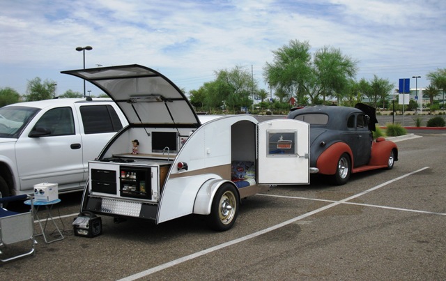

Postby emiller » Tue Jun 21, 2011 6:27 pm
Not all aluminum skin tears oil can. Mine doesn't, but is steel framed with a lot of rivets.
