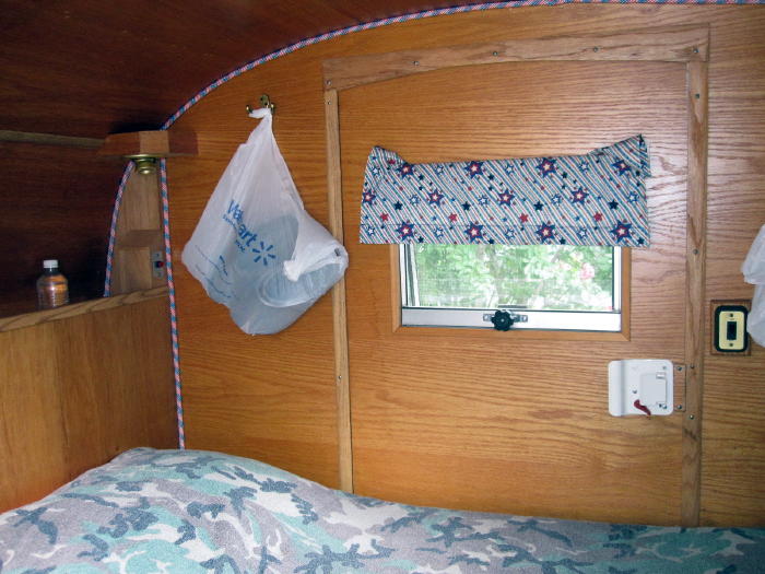

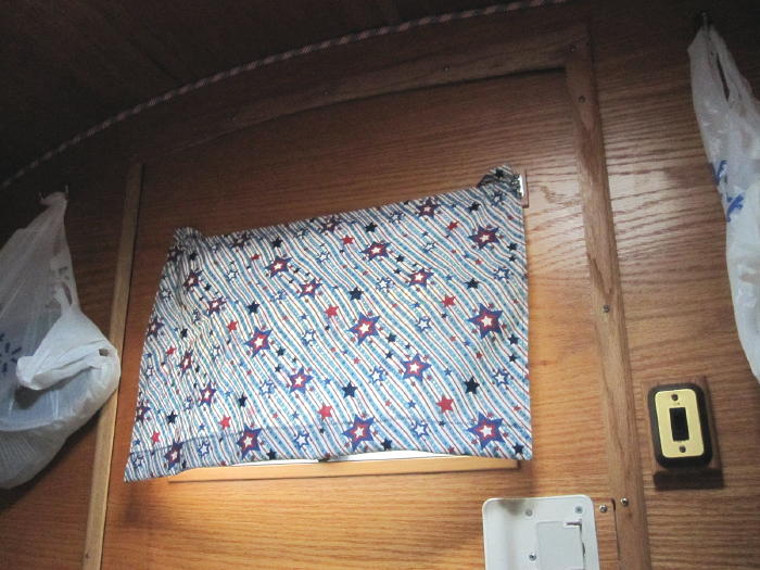

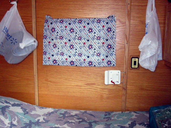

That'll work! During the day our curtains are 'tucked & folded' up over the curtain rod, windows usually open a few inches. When we go to bed we lower the curtains & if needed turn the fantastic fan on (low). The fan draws air thru the windows & the the curtains 'deflect' some airflow downward on us. We have a PetCool AC but seldom use it except in extremely hot/humid conditions. The fantastic fan drawing in the cooler air thru the door windows works very well - most nights we hafta turn the fan off sometime during the morning hours, too cool... :D
curtain position - daytime
curtains closed for night - windows open - fan off
windows open - fan on
