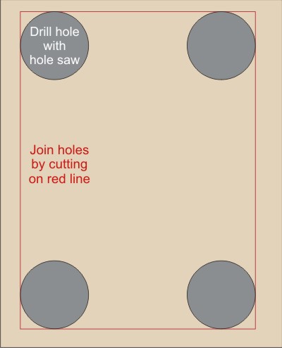

4-5 inche radius is a pretty wide sweeping curve. If you were wanting to do someing thing a little tighter, you can use a hole saw to cut a round hole at each corner, then you just between the holes, leaving just the nice rounded corner. I have done this with corners up to 2" radius, using a 4" hole saw. I hope that makes sence, I am at work an really don't have a way to draw it.

Like this Tom ?
join holes.jpg (21.09 KiB) Viewed 517 times
sorry about the size of pic, I;'ll need to work on that.................. :oops:

Exactly!! I could have done that at home, but not here at work. Thanks for drawing that for me.
I have used this technique in the past and have been happy with the results. I think this will make a very nice template for the OP.
