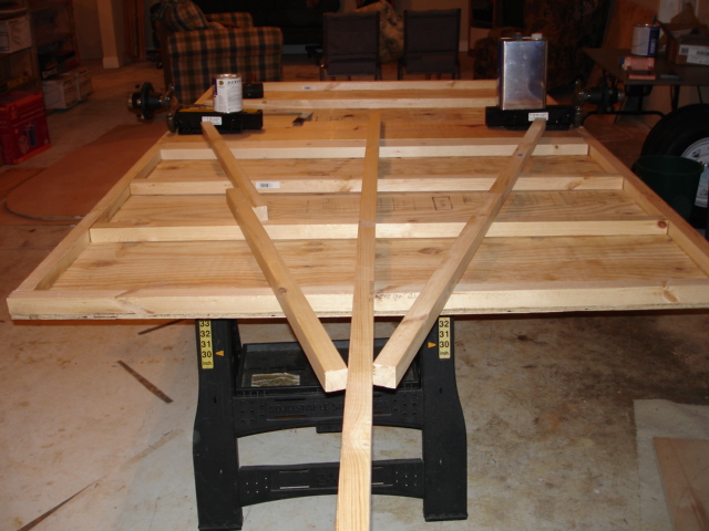

Postby Geron » Mon Jan 22, 2007 8:22 am
OK Ladies,
I'm "fixin'" to go buy my 2 1/2" square tube and 2x2x1/8 angle. Here's a pic of my "idea"
Please critique and offer advice before I get into too much trouble.
Geron
DON'T LAUGH "Fixin'" is a good southern word. We use it as a noun, verb and adverb. I'm sure it can be used as an adjective also.
Image[/img]
More pics in Album
The 2x2's represent the tubing and angle. The angle will be bolted through the middle bolt on the axle.
The tubing and angle will be bolted to the floor at appropriate places.
Yes! yes! Yes!! I'm gonna put her together in the garage -- Not the basement. :R

Postby angib » Mon Jan 22, 2007 1:22 pm
Looks fine to me. A couple of comments:
- The 2.5" square tube will be more than 7 times as strong as each 2" angle, so the angle won't add much vertical strength. The angle seems to stop only a very short distance in front of the trailer floor, so it also won't add much horizontal strength.
- I'm not a big fan of these composite tongues (ie, central tube and angled braces) as one or other of the parts isn't doing much good. You could throw away the centre tube and just use stronger tubes for the angled braces.
Andrew
