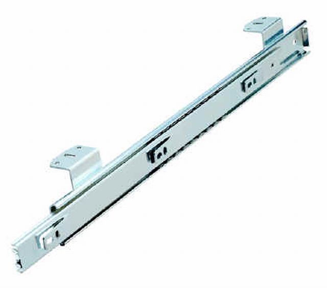

Can anyone tell me how this would be installed since I dont want to put too many boards or such onto the Mahogany...Could it be installed to slide out by setting the slides directly onto the bottom of the countertop ?
The Counter is 22 inches in depth.. So Im going to cut the side piece the same with and curve the front so it matches the rest.. of the counter.

Heikki, they make bottom mount slides...don't know about availability over on your side of the pond...you cannot use regular "side" slides for this...

madjack wrote:Heikki, they make bottom mount slides...don't know about availability over on your side of the pond...you cannot use regular "side" slides for this...
madjack 8)
Madjack would they be the same as these ... I ordered a set this morning for the cooler... that can be mounted to the floor...these say bottom mount
and these are side..
Learning another new field... :? :shock: :oops:

...if that is their claim, then yeah, you should be able toooooo.......... 8)

I don't believe either of these is what you're looking for. The first one which says "bottom mount" actually sits on the side of the draw/shelf and then are screwed to the unit by those L shaped brackets/protrusions --- that is they are screwed to the bottom of the unit but the bracket itself sits on the side.

Creamcracker wrote:I don't believe either of these is what you're looking for. The first one which says "bottom mount" actually sits on the side of the draw/shelf and then are screwed to the unit by those L shaped brackets/protrusions --- that is they are screwed to the bottom of the unit but the bracket itself sits on the side.
I could be wrong!
Philip

What you want (I think)is a top mount drawer slide.
That is if you want to mount the shelf under the counter to pull out and then set the stove on.

Andy Ehle wrote:Finn
Yes that is what I wish for shure ....Is that slide from the Finnish Site?
I,ll ask the company before I order...for availability...
There is a place that sells the accuride slides here too for 40 - 50 Euro a pair. or 40.00 EUR = 53.4682 USD UGH.
UGH :shock: :shock: :shock:
Thank You Much...Under the counter to pull out for the Stove...
