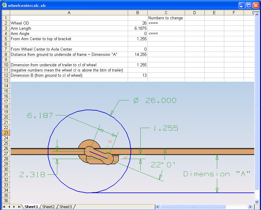

Postby mikeschn » Fri Jul 06, 2007 4:05 pm
Howard,
Look at this pic as a starting point. If you use a torsion axle with a 22 deg down start angle, your ride angle will be at 0 degrees. Using 14" wheels, your wheel diameter is 26". That puts the underside of the chassis at 14.25
Now just work your way from the underside of the chassis to the center of the ball!
Then get a new ball mount for the truck! ;)
Postby Weerider » Fri Jul 06, 2007 4:20 pm
Thanks Mike and MJ... that's exactly the kind of info I was looking for. Door sitting sounds good... Guess I'll have to decide on mattress thickness now. Don't really want it slammed as my truck definitely isn't slammed.

Postby Alphacarina » Fri Jul 06, 2007 4:30 pm
Handy chart Mike!
It looks like it's not practically possible to get it too low - Even buying axles with an upward arm start angle, and using low profile 14 or 15 inch tires (my 15's are just 24 inches in diameter) you'll have a ride height in the 12 inch range - I would much prefer it be 8 or 9 inches if possible on mine as my tow vehicle (a compact car) doesn't have any more than that and keeping it as low as possible will give it less wind resistance behind the car

Postby mikeschn » Fri Jul 06, 2007 4:40 pm
Here is that wheelcentercalc spreadsheet if you want to plug in your own numbers...
http://www.mikenchell.com/images/wheelcentercalc.xls
