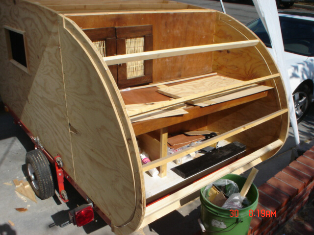

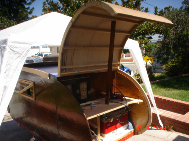

I have been holding off on getting all the trim done on my camper because im having a hatch problem. It looks like i need to do a rebuild. ;o( My hatch has a lot of flex right now. Long story short.. i have a crack in the left side frame, and two horizontal cracks on the skin. Due to the shape and size i need to come up with a way to keep the new hatch from having so much flex. Here are the best pix i have of my hatch. Old pix but you get the idea of how its built. Any ideas?

Nic... Yeah, you could make a new hatch and build it stronger; but that one looks fixable to me. About a quart of epoxy and some fiberglass or use some fumed silica or milled fiber filler in the epoxy... making some fillets in all the joints will make for some very strong joints. Then skin the inside, gluing it to the spars with PL urethane... And, add a new skin on top of the outside the same way.
I'm sure others will chime in with good ideas too, but that's about how I would do it. Good luck with your project... Nice lookin tear. :thumbsup:

I think that an interior skin(and rigid insulation) would help alot, but I also think that you should use some vertical bracing between the horizontal ribs that you have.
If you decide to rebuild, try using verticle ribs for all the main and putting some horizontal bracing between them. Also use an interior skin.

Postby mikeschn » Sat Jul 07, 2007 6:29 am
Something like this would work...

mikeschn wrote:Something like this would work...
That's the way I built mine. I have no skin on the inside, and it's plenty ridgid.

Mike's framing plan would result in a much stronger hatch.
That's the way we'll be building ours. Of course the plans call for it to be built that way, but I'd initially thought of the side to side framing in order to fit some storage pockets in. But when I played with it and mocked it up in cardboard it was very weak.

Nic...you might try just putting in some gussets at all the ends of the hatch stringers before you start all over. I think that would add a lot of stiffness to the whole thing and help prevent it from racking. The longer the gusset, the more strength will be picked up...and an interior skin of 1/8" using the glue of your choice wouldn't add that much weight to it. Just an idea...Doug

The main problem as I see it with omitting the vertical frames and just using horizontal spars is the spring-back problem....it's the vertical frames that prevent spring-back.

Perhaps the cracks and splits are more a result of the hatch not being secured well. Yes you should fix it but your support poles need to be held in one place. Something that keeps it steady. Hinges or bolts...
You can always skin over the top and sister side ribs on the ends. Then add some bracing like Mike has pictured. Glue and/or pocket screws will do it.

I agree that you're really asking a lot of the only 2 vertical framing members you have
I would think 3 would be an absolute minimum for a hatch with not much curve to it - As much as you have, I would use a minimum of 4 but more preferably 5 if you really want it to last

SEE i knew you guys would come up with some good ideas for me!! lol When i built the hatch i had help from a guy i kinda look up to when it comes to wood working. BUT... i think he thought he was the stuff because he rushed getting the skin nailed on. THe skin didnt have much time to bend and it cracked. So i put another skin on it to cover the crack and now the new cracks are in the same spot. So its heavy as it is i dont want three skins on the outside. I had plans to skin the inside of the hatch but i was having problems with the hatch so i held off. Speaking of having an upper and lower hatch! I was thinking maybe i could do that but split the bottom hatch into two sides and make each side be the face of slide out storage for food and my ice chest. I LOVE having my hatch up over my head though because i want to add some cool lights one day. So i dunno. The crack that i have on the frame is right at a screw hole. I thought about a brace on the inside of some kind. All this thinking of things to add to my hatch makes me think i should just build a new one. Anyone wanna build it for me!? HAHAHA! :? I think im going to take my time looking at all of the good ideas and end up with one great hatch one way or another! Wish me luck!

If there are horizontal cracks in the skin, that doesn't mean it has anything to with the ribs and springback:
Unless they're REVERSE cracks.
My guess is that because of that tight curve/radius there, it's just the skin material being used that didn't hold up, and the epoxy fix seems like the best solution.
Where exactly is it cracking?
