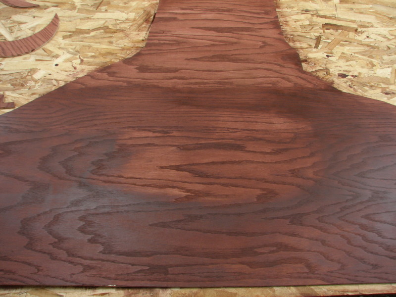

My wife's first job with this teardrop project is staining the wood sides. Currently she is staining 1/4'' red oak with a waterbase stain. As you can see in the picture some of the wood is holding color better then other parts which inturn is making her very stressed :cry: :x :x :cry: and making the wood look like *#@!. :x Is there anything that we can do to fix this? Can I sand the darker spots with some 200 grit and start over? I need help.

Mike...I take a pretty damp rag and wipe down the heavier stain, rinse it off in a bucket of water and reuse the rag. You'll be surprised how much comes off. You can also thin the dye to "doctor" up any areas that don't fit the look you want. Blend it in with a wet rag. I usually apply the dye and then start mopping while it's still wet to get it even. Don't do it in the direct sunlight. It'll dry much quicker and make it more difficult. Just what I've experienced using an aniline dye. You want to get the excess off the wood. Doug

Well she tried the water, but I think it already dried. Remember how dry it is out here in Colorado. She's getting the technique down better as she goes and is making the bad peice look better. The overall look is a bit darker then planned but I do think it's better. I'll take another picture when she puts the final coat on the stain.

thin out some of the stain and do an overall wipe with a damp rag on the entire piece as a last coat, can use a roller also, covers more ground equally in a hurry. Get it completely wet, as that's how it's going to look when you put the epoxy on. I'd also check for dryness prior to putting any epoxy on it. Depending on just how wet you get it, it may need more dry time. I'd just roll on the first coat of epoxy, but if the fuzz is really bad, use some really fine grit paper, don't cut into the wood, just get the fuzz. It's thick enough that any of the fuzzies raised with the dying process will be taken care of on the first coat. If not, sand the epoxy. Any serious sanding on what you have done now, may cause a color change and you will fill the pores with the dust. Just my ideas on it. others may vary. doug

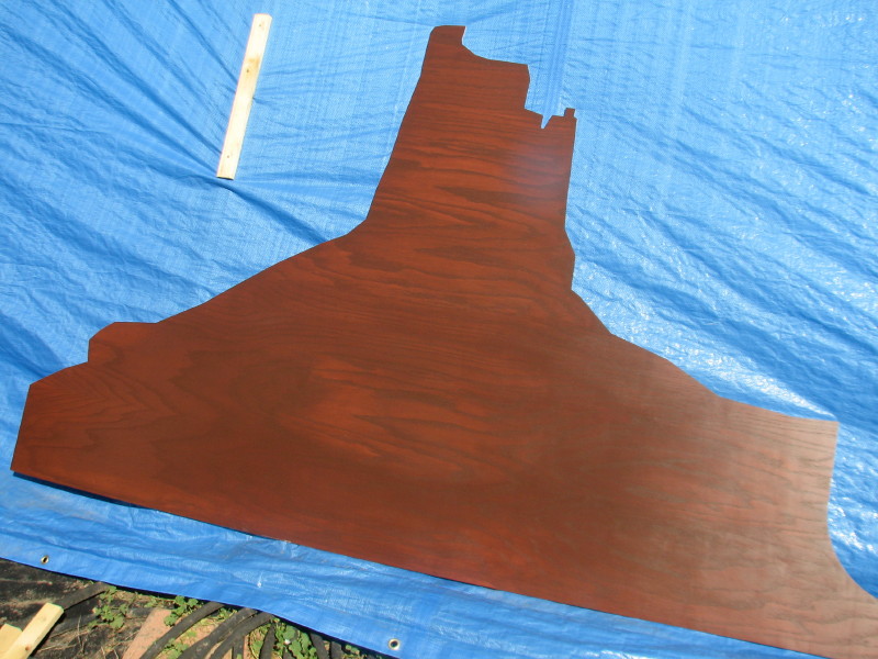

Fixed stain piece, you can still see some of the spot, but it's much better.

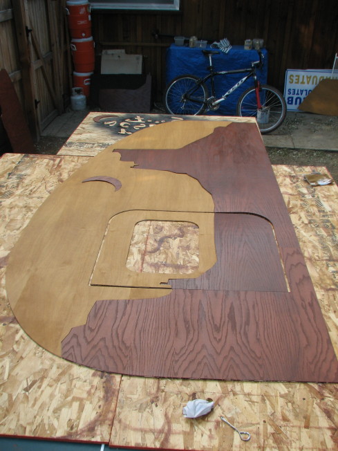

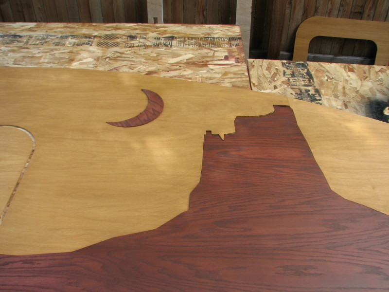

Becky staining
One side done with stain.
close up
Long shot
