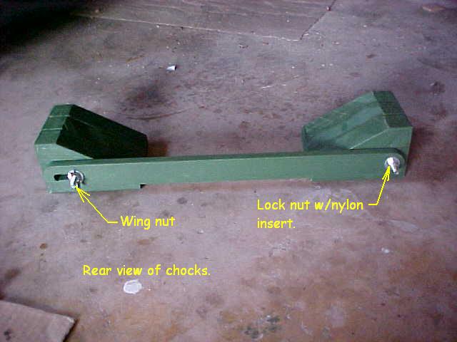

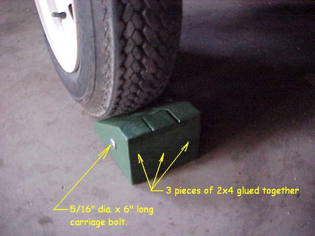

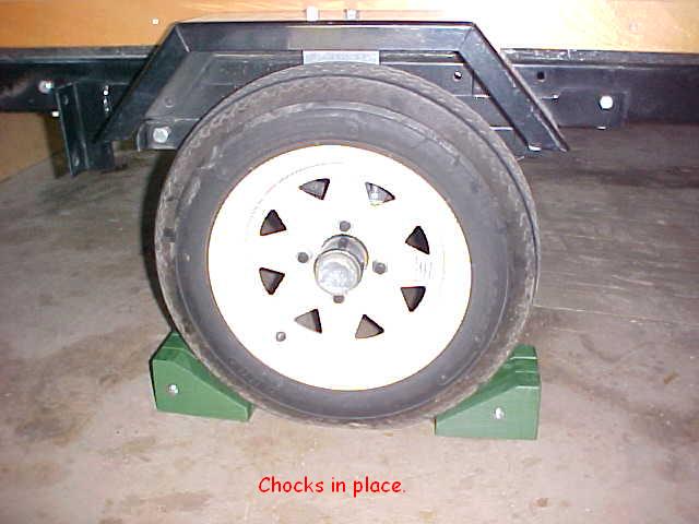

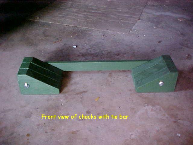

I've been using scraps of lumber for wheel chocks on my tear, so I decided to make some better ones. They're pretty simple. Each one is made of three pieces of 2x4 cut on an angle and glued together. A 6" carriage bolt runs through them and attaches to a 1/2" plywood tie bar. A 1 1/2" long slot on one end of the bar lets you slide them apart, and slip them around the wheels. then push them tight against the wheel and tighten the wing nut. Here are some pics.
I think they'll work!
Sam

Sam I am wrote:I've been using scraps of lumber for wheel chocks on my tear, so I decided to make some better ones. They're pretty simple. Each one is made of three pieces of 2x4 cut on an angle and glued together. A 6" carriage bolt runs through them and attaches to a 1/2" plywood tie bar
What is the advantage of having the tie bar inside the wheel where you have to bend your wrist around and tighten the wing nut only by feel?
Seems like it would work just as well (and be easier to use) with the tie bar on the outside?

Postby Sam I am » Fri Oct 19, 2007 7:44 am
Don, they could be used with the tie bar inside or outside of the wheel. I showed them inside strictly because I thought they looked better that way. You're right, it is easier to tighten them up with the tie bar in front.
Sam
