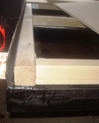

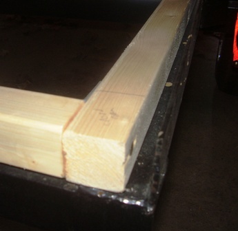

Hi Gang,
OK, I've got a few of very specific build questions. Please see the pictures below. I framed out my subfloor frame with 2x2's, leaving 1/2" on either side to attach my 1/2" plywood side walls, which will go between the wood floor frame and the metal lip of the trailer. I know that I need to somehow 'seal' the part of the walls that are going to be sandwiched in down there, but I am not ready to seal the whole trailer yet, so what do I do? Once the walls are down there behind the lip, I won't be able to reach them to seal them.
Secondly, regarding bolting the floor to the trailer, should I just bolt the 2x2 frame, countersinking the bolts, then attach the 1/2" plywood floor on top of the already secured frame? , or should I run the bolts attaching the wood to the trailer through both the subfloor frame AND the 1/2" plywood floor. If I do the latter, can I countersink the bolts in the plywood?
Lastly, what kind of bolts did you use to secure the floor to the frame. I am assuming I just drill holes through the steel trailer frame, too?

Alfred, I sealed the bottom edge of my walls with epoxy then glued them with PL construction. (not the blue stripe) I didn't put epoxy on the side where it met the framing. The glue should act as a sealer.
I would glue and attach the floor and the frame to the trailer. Counter sinking is good. That way if you ever need to get to the bolts you can. You can still fill the counter sink holes with something you can remove if needed.

Alfred wrote:Once the walls are down there behind the lip, I won't be able to reach them to seal them.
You've got quite a problem there. As well as sealing them, I'm not sure how you're going to fasten the walls to the 2x2s, as the frame stops access for that too. If you're relying on just glue and a tight fit, you run the risk of wiping the glue off the joint as the ply goes in.
And I reckon this is a very critical area - you've got a water trap where the frame will pool water against the sidewall and 2x2 giving perfect conditions for fast rot. So a really good seal is needed between the sidewall and the frame to stop water getting into this area. If you're skinning with aluminum, it would be good to hang the aluminum down over/outside the frame.
One solution, which I admit sounds a bit drastic, would be to make the floor bolts accessible through the ply deck and once the floor is sheeted, lift the whole thing up on spacers by say 2-3" and build the trailer body 'in mid air'. Once the body is complete, drop it down onto the frame and bolt in place.

Thanks for the feedback. In retrospect, maybe I should have framed the wood out all the way to the edge, and planned to attach the walls at the floor - There is the option of adding another 1x2, to one side or the other, to widen the floor frame perhaps? Or I could bite the bullet, buy more 2x2's and start over -
Otherwise, I had thought about the potential problem of water getting down in there as it is, and was planning on caulking and maybe adding some sort of trim over the edges. Was not planning on using aluminum, at this point.
Meanwhile, as per Andrew's suggestion, having not bolted anything yet, perhaps I could build the cabin on cinderblocks until I get the walls on, then drop the whole kit & kaboodle on the trailer after I have sealed the walls?

Pete, I think the most vulnerable material there is the bottom edge of the plywood sidewall - those cut edges of plywood are dying to soak up water, even through paint, so almost any other wood in the area has a longer life expectancy.
So I reckon protection is what is required and that means being able to coat that corner after it's assembled.
Though perhaps another idea would be to fill that groove (between the frame and 2x2) with thickened epoxy and just push the sidewall ply into place. There is no human condition that epoxy can't solve!

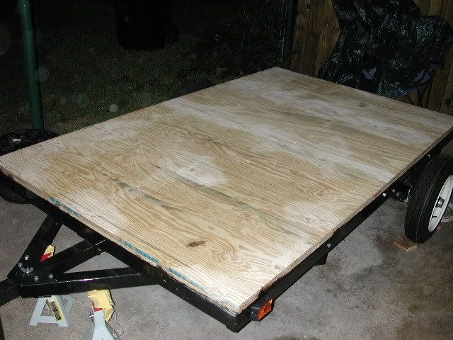

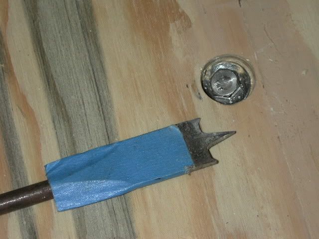

I assembled the floor and then bolted it to the frame.
Bottom side up in this pic.
Don't forget to countersink the holes big enough for a socket wrench to fit.
Then just fill the holes with wood filler and then cover with what ever flooring material you like. I just went with 12" vinyl tiles.
I can not remember what size bolts I used though :thinking: Sorry. :oops:

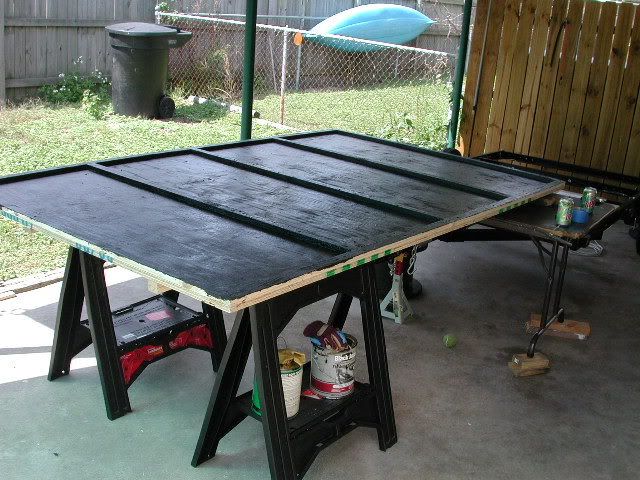

So this weekend I bit the bullet, discarded the old floor frame made from 2x2's and built a new frame from 2x4's, extending it all the way to the edge of the trailer rim. This solves the problem described in the preceding messages.
New frame from front.
New Frame from rear.
Close-up new frame from rear. Notice on the sides and front, the trailer rim comes up about 1/2 way.
My plan is to attach the walls to the part of the 2x4 exposed above the rim. I have a couple of questions...
1) I have seen many of you paint the bottom with roofing emulsion. Would I only paint this up even with the rim, since I will be attaching the walls to the exposed part?
2) How do I actually bolt the frame to the trailer? I bought these self-tapping bolts, but they are only 3 1/2 inches long? The guy at the bolt/screw store said these would drill through the wood and right into the steel trailer. Should I countersink and use them to attach the 2x4's before I put the 1/2 inch ply floor on top of the 2x4's?
Thanks for feedback!

I have the same floor and frame as you but I put 1/2" plywood on the bottom and the top before attaching it to the frame. I drilled holes in the frame and used 3" stainless steel hex head screws. I screwed them from the outside of the frame into the 2x4's. I didn't want the sharp screws sticking out the bottom of the frame.
