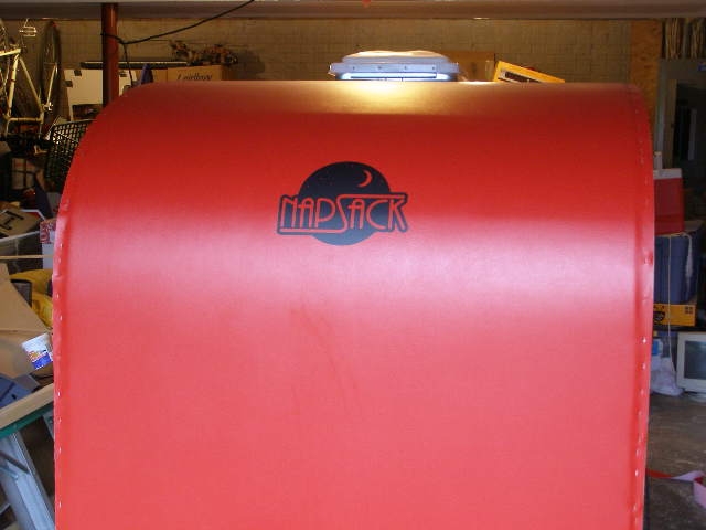

I couldn't wait so I mounted the logo!
I've another one to put on the hatch

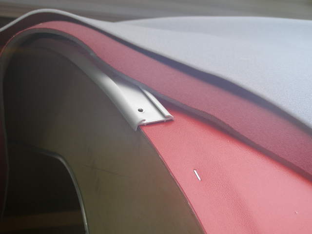

This picture shows the edge molding I'm going to use. I just cut off a foot or so to test fit. It'll have a red insert the same color as the roof.

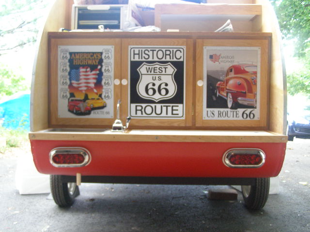

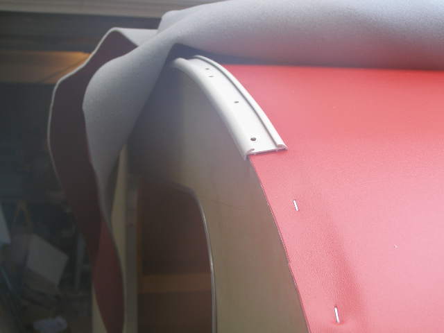

Here's a pic of the headliner I used -- also from Joann with a 40% off coupon. It's burgundy on one side and as you can see foam on the other. It's a little more than 1/8 but less than 1/4 in thickness. I glued this down first and floated the vinyl. I just hope that it doesn't ripple much in the sun. I think I have it taut enough to prevent that.
Also a pic of the rear end with the vinyl fitted and the rear lamps "resting" in place.

That's sweet. That's the exact same molding I have sitting in the garage.
Thanks for the photo!
