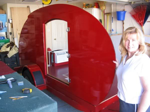

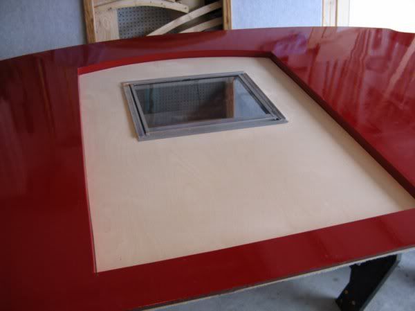

I built my doors and placed the hinges while my sides were still flat on sawhorses. It made it much easier to position the hinges and get the spacing just right. I put it all together and made sure everything fit and then lifted the door off the hinges before I put the sides on the trailer. The lift-off hinges worked great. Once the sides were on the trailer, all I had to do was slide the door back on the hinges. The sides were stiff enough that I was not worried about anything shifting.
Here is the blank I cut out earlier, testing for fit and spacing:
Here is the door after it was built and I was attaching the hinges:
Here we are on side raising day. Note the hinges on the side and the interior door frame and weather striping already in place:
ImageMark (& Cindi)

Mark (Planovet), your pictures are really helpful and encouraging. (The shiny red finish on your tear is amazing!) :thumbsup:

Wow Wow Wow planovet,
Only just seen those close ups of your walls. What an AMAZING finish!!!
I assume that's epoxy, plus a zillion hours of sanding, then a sprayed finish? Abslutely STUNNING. :applause:
