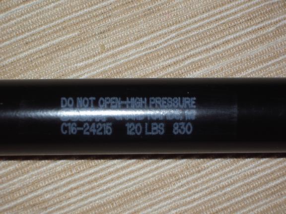

bbarry wrote:I received my gas springs today from McMaster. I ordered ones with 120lbs force each on the recommendation from several members here. I am completely unable to compress these springs by any non-mechanical means. I'm not a hulking gym-junkie by any means, but even putting one end on the ground and using my entire weight (160lbs) I couldn't get them to budge a bit.
Is this normal? I tried turning the plunger end in case there was a threaded lock of some sort...no dice. I can always put a pipe clamp on them to make certain they compress, but I don't want to force anything. I for sure don't want to install them until I know they're okay.

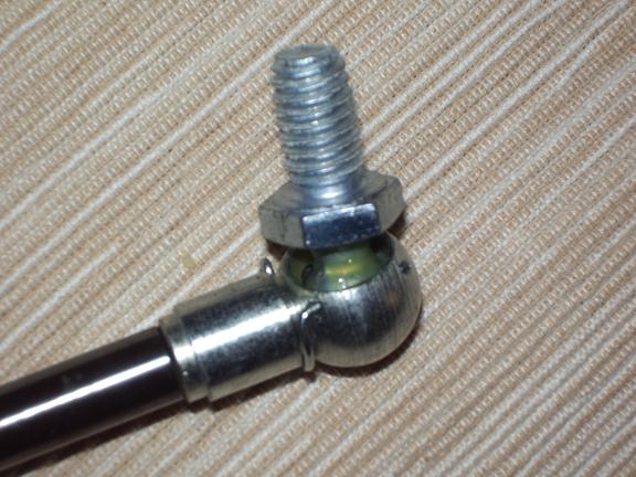

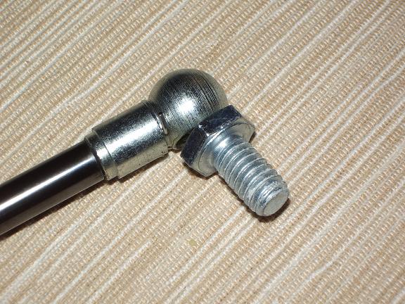

mikeschn wrote:How do you like the ones from McMasterCarr? got a good close up photo of the end where you screw on the fitting?
mikeschn wrote:I like them...
Is that the model number, the C16-24215?
Jiminsav wrote:the problem is, thats the wrong end for what you want to do. you need a end like these.
