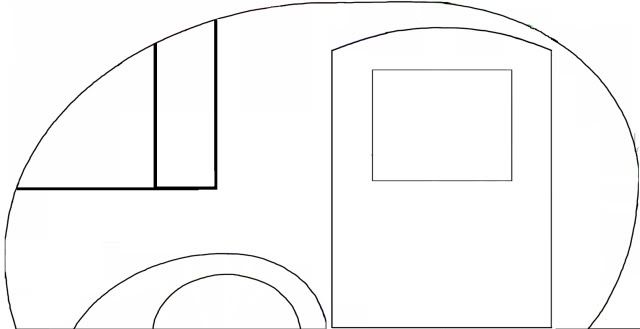

Here's the profile I've added lines for placement of a galley shelf and a thin cabinet reachable from both sides there will be no under the counter cause feet will go to the back. I do think I'll split the back to hinge down and up so I can slide a mattress in under the counter.

I really like your profile that will be a sweet little sleeper trailer.
That upper bulkhead and shelf will stiffen up the walls a bunch.
