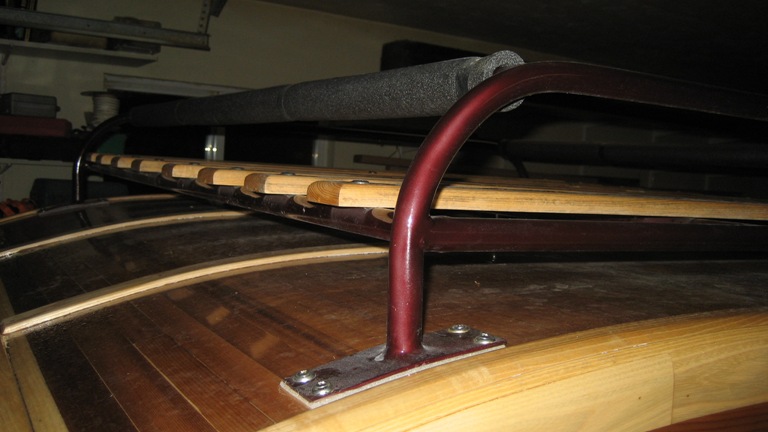

Postby Noob » Thu Mar 04, 2010 9:58 pm
The fastners on the sides ... should they go into the roof spars ? ... or through bolt them, to the walls ? ( the lil' bear ones look like they are bellow the roof ... )
I doubt the *short* fastners ( in my pics ) just going into the side will be enough.

Postby grant whipp » Sat Mar 06, 2010 11:13 pm
Noob wrote:The fastners on the sides ... should they go into the roof spars ? ... or through bolt them, to the walls ? ( the lil' bear ones look like they are bellow the roof ... )
I doubt the *short* fastners ( in my pics ) just going into the side will be enough ...
Through-bolting 'em is better, Noob, with a sizable washer on the inside (equal to or slightly larger than that of the rail section you are mounting to the outside wall). I typically use a 1-1/2" SS fender washer (SS bolts & nuts, too).
DasBaldGuy ... the 4 towers, both cross-bars, and the 4 SS "Quick-Rails" are included in the set ... all you need to supply are the mounting bolts (I recommend SS bolts appropriate to your wall thickness, SS nuts & washers).
