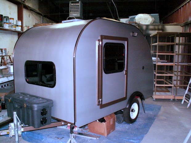

PS: I've put some photos in my album showing what I did.
I used the door as a template for the frame trim and screwed it every 2" as I bent it. I also clamped on backing ply to stop the trim from twisting. The 3/4x3/4 "T" tim was the least problem. A hammer with a block of wood can be used to tap out wrinkles.
1" is a bit much to bend tightly in compression. Try to use 1/2" or less if possible.
