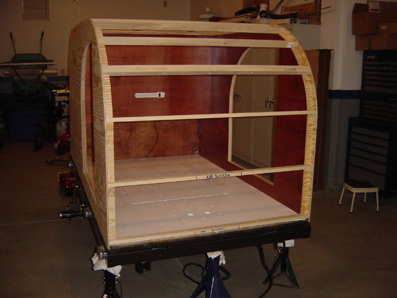

Postby bobhenry » Fri May 07, 2010 7:24 am
I cut southern yellow pine from #1 grade 2x12's into 2x2's
( 1 1/2" x 1 1/2" )
The SYP is about 50% stronger than the spruce pine fir grade.
They were spaced 12" on center.
I rabbetted the ends to fit a notch in the sides as you can see in the pics.
Postby dh » Sun May 09, 2010 9:20 am
I'm doing similar to BH, couldn't find a single straight 1x2 so I'm making my own. I got a 2"x12"x12', and had them cut 2 pieces out of it 62" long (my interior width) so I just have to rip my spars. Also, you don't have to double up any spars, just rip a 2x2.
Ignorant doesn't know any better, Stupid knows better but does it anyway.
