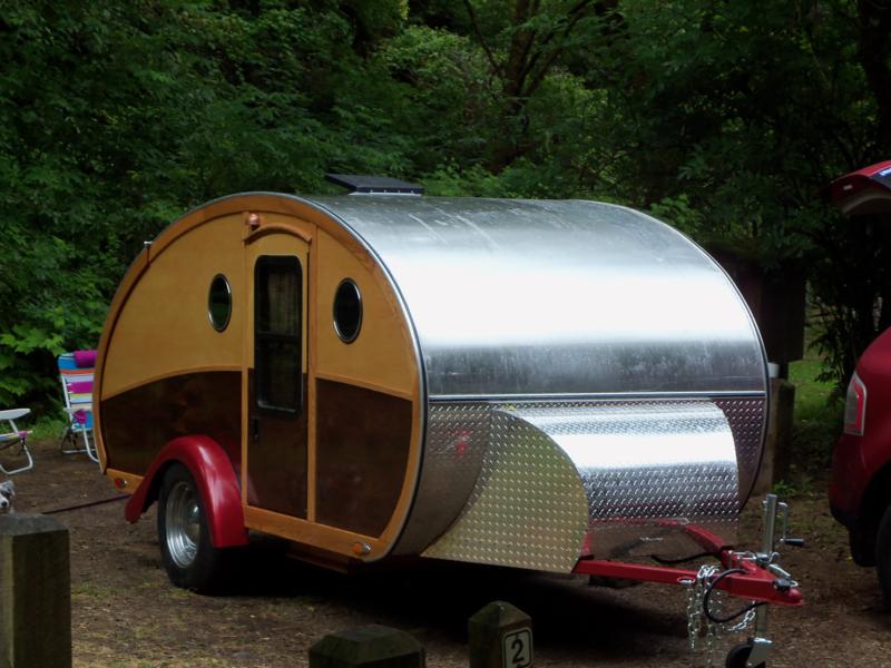

As tears go, mine is big. Body is 12' long and 5' tall. I used 5 pieces to make a side.
Top & bottom front, top and bottom back and a piece over the door.
Being a Woody, oak trim hid all the seams. That way the seams did not have to be real tight, they are all under cover.
Wolfgang
