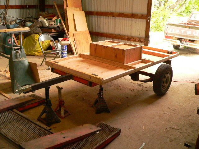

Postby bobhenry » Sat Nov 20, 2010 8:05 pm
I still like the outside access drawers on Erv's rig. It just seem a lot more practical than balancing a mattress on your head and rooting around trying to get to the storage from inside.
Here is a link to the pic above.
http://mikenchell.com/forums/viewtopic.php?t=28637&postdays=0&postorder=asc&start=0

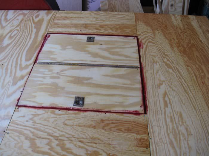

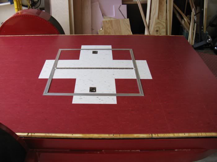

Postby planovet » Mon Nov 22, 2010 9:19 am
I just built in a box with a cover hinged in the middle. I have to lift the mattress to get to it but we only store stuff in there that we will need only in emergencies (extra towels, sheets etc.). I wouldn't use it for things you need to get to often. The only thing I would have done differently is that I would have made it wider, extending it more toward the sides. That would give extra storage and be a little easier to get to. Otherwise it works well for us.

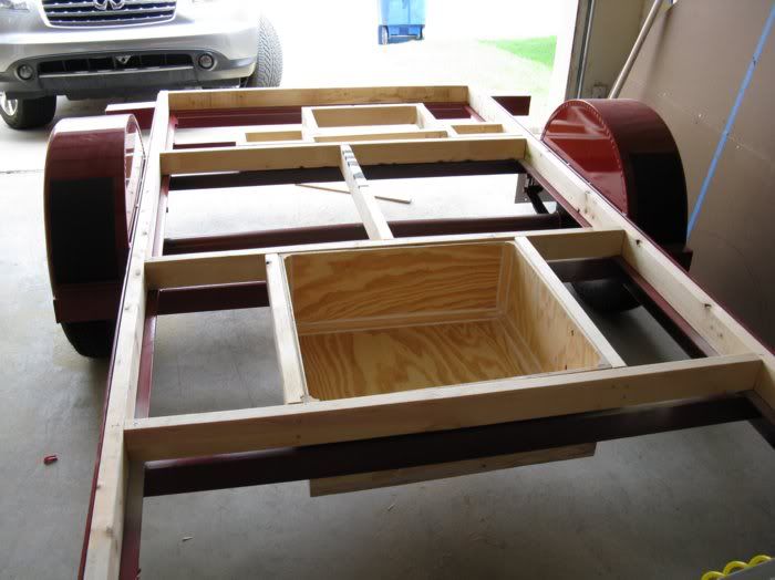

Postby Wolffarmer » Wed Nov 24, 2010 1:26 am
As I made mine for rough roads light 4x4 it sets rather high so I was able to put a deep "foot well" in mine.
Thats upside down. Mattress is 3 hunks of foam. the middle hunk over the foot well goes up to the front of trailer to make a little couch and I can set in there with reasonable comfort in bad weather and read. Later I made the bottom part a trap door so I can open it and stand on the ground and now I can stand up in my tear drop. There is usually enough head room for my 5'9"
I store my leveling jacks, blocking, door mats, winter shoes, in there when on the road. Of course after it is set up usually the shoes is the only major thing left in there.

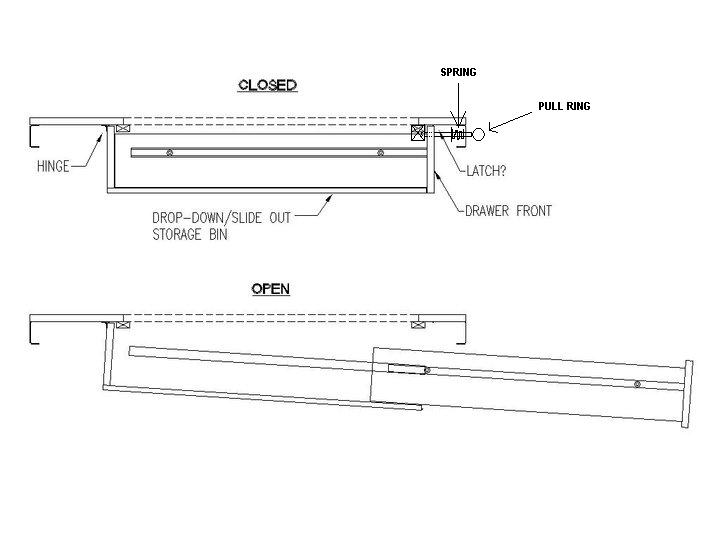

This thread has be thinking about some sort of hybrid underfloor storage - a bin that could be accessed from a panel inside, but also slide open from the outside. I might be a little crazy. But I'm ok with that :)
So... what about a bin that is open on top, and hinged on one side so that can drop down to avoid the frame rail, then slide out the side like a drawer?
Weatherstripping would be around the opening in the trailer floor so when the bin is closed it would be weathertight. Then there is also weatherstripping on the front of the bin at the slide out drawer.
The latch has a ? behind it because I'm not sure what latch might be suitable for this.

Postby absolutsnwbrdr » Wed Nov 24, 2010 11:50 am
oh... and my reasoning for it having to hinge down is that I dont want a really deep bin that could sacrifice ground clearance and get pummeled with dirt/rocks. This could also be an option for lowered teardrops.

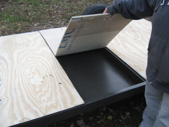

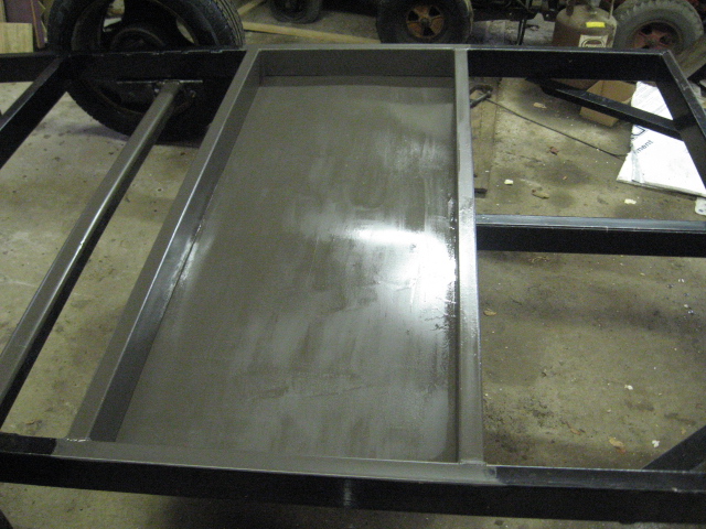

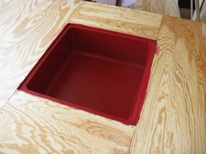

Postby cuyeda » Wed Nov 24, 2010 2:12 pm
Coincidently, I have thinking this same subject, thanks for posting. These are other peoples photos, but saved in my archives.
The tire bin is from Camp-Inn. They will sell it separately.
another storage...
Depending on standard sizes (vary), something like this concrete mud pan, could be used if storage items were not heavy. I am sure other standard plastic bins could be reseached. It's water resistent from the road side, and could be replaced with another if an accident were to happen underneath.
This is Steve Fredericks dropped floor build on his Rondack Lodge. It could easily be covered with a lid for a storage area.
Looking for other ideas as well.

Postby parnold » Wed Nov 24, 2010 2:12 pm
Zach:
You'll want the latch mechanism to be easy to reach.
This may be overkill, but otherwise you'll be on your hands and knees to reach the latch.

Postby absolutsnwbrdr » Wed Nov 24, 2010 5:12 pm
parnold wrote:You'll want the latch mechanism to be easy to reach.
I like it Paul! Looks like I might have my next project!
