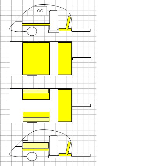

Postby Ben W » Thu Jul 14, 2005 2:22 pm
I'm in the planning stages right now and faced with the 2+2 issue. Here's an idea I came up with after looking at the Camp-in Rain drop. If it's been done before I'd like some feedback. Yes, it's a bad drawing, but it conveys the idea...

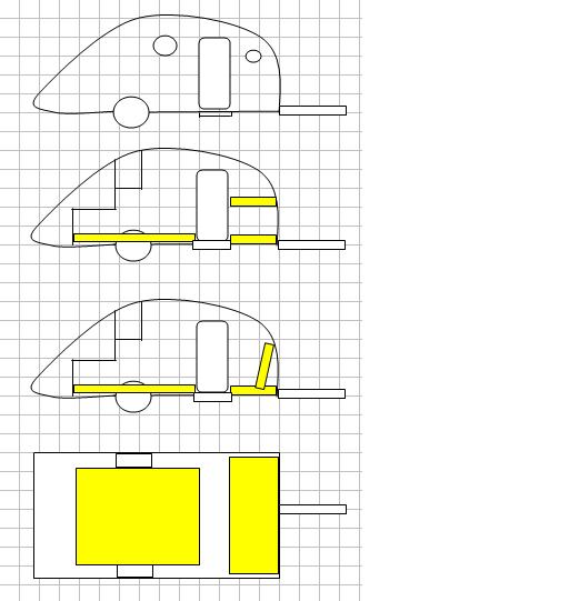

Postby Poputer » Fri Jul 22, 2005 10:25 pm
I like the ideas I’ve been seeing on the posts. Plus, finally seeing Camp-Inn’s beautiful “Raindrop” and some discussions about 4-5 person teardrops made me want to post these ideas.
I’ve been playing around with the idea of a 4 person tear for almost 2 years. Here are my 2 best ideas that meet a few requirements for me. Currently my design is 6’6” wide, 4’-5’ tall and 12’ long (144 inches). I have always loved the fiberglass egg trailers (Casita, Burro, Scamp, Trillium, Boler), but having caught “teardrop fever” 3 years ago, can’t seem to let go of the idea of building my own, customizing it myself.
http://tnttt.com/album_ ... ic_id=2235
http://tnttt.com/album_ ... ic_id=2236
I am 6’2” and so the main mattress needs to accommodate me and my wife so it must be at a minimum 5’ wide. Also if the main mattress is place width ways the trailer needs to be 6’6” minimum, and it could be made into a benches and table with storage under chairs where the wheel wells are located.
I like the idea of having a small walkway between the beds, for shoes and such and if a lower box is created, the bunk could be lowered so that it makes a seating area/couch.
I also wanted 2 beds for my 2 kids. But I think I want the 2 bunks to be big enough to sleep in for myself or my friends should I happen to go on a “fishing weekend” which means we wouldn’t have to put up a tent.
This could be made only 4 feet high inside to improve aerodynamics. Also the width could be made less if just for small children who will be “kicked” out once they are old enough to sleep in a tent, or if need for 5 just add a bunk above the main bed.
Perhaps using this interior and bunk layout with an exterior similar to Andrew’s (Angib) 2+2, especially the larger (5’) one listed at the bottom.
http://www.angib.pwp.blueyonder.co.uk/t ... tear47.htm

Postby mikeschn » Sun Jul 24, 2005 5:24 am
I think the second scheme... (this one: http://tnttt.com/album_ ... ic_id=2236 )
has some promise. You could even have a table set up inbetween the benches for daytime use. The table could even seat 4 people.
That of course requires a 5' high trailer. You're making good design progress. Keep working on it...
