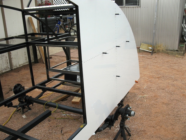

CARS wrote:I'm new here so be gentle, but aren't any of you worried about galvanic corrosion? When 2 dissimilar metals are joined without any form of insulator, corrosion will occur. This is why you will often see paint flaking around rivets on semi trucks and boats.
In my body shop I even have different tools for working aluminum because I don't want future paint problems because I "forced" a chip of steel into the softer aluminum.
