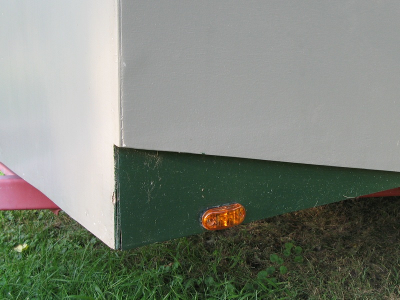

Postby mikeschn » Tue Mar 22, 2011 3:56 pm
I used baltic birch plywood on one of my builds. Even with CPES on the endgrain, it wasn't enough to keep the plywood from delaminating.
So my first choice in plywood would be a marine plywood, expecially if you are not going to cover it in aluminum.
Postby GPW » Tue Mar 22, 2011 4:03 pm
Gosh Mike , that's depressing !!! Do you think fiberglass tape and resin would have helped ... guessing you'd have to do all exposed seams/edges huh ???
