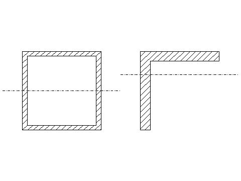

ive just built a little utility trailer for my mower and used 2" * 2" * 1/6" angle in an a frame for the draw bar
and when i checked out andrews tongue strength calculator http://www.angib.pwp.blueyonder.co.uk/t ... tear00.htm
the way I read it is that square tube of the same weight is nearly 3 times stronger than angle? is that right?
ie. 2" * 2" * 1/4" angle has a section modulas of 0.188 and 2" * 2" * 1/8" square tube which has the same ammount of steel in it has a section modulas of 0.511?

2) Angles are fairly inefficient structural members in bending, whereas square tubes are really good. So for the same weight, tubes are stronger.
If you want the tech-y explanation, it's like this:
The problem with angles is that they are not symmetrical, so one side fails long before the other side is fully loaded. When bending anything, there's a point on its cross section where the stress is zero (ie, neither in compression nor in tension) - it's called the neutral axis. I find it easiest to think of the neutral axis as the 'centre of gravity' of the section (which it is). For a tube the neutral axis is in the middle, but in an angle it's much nearer the flat:
That's real data for a 2" x 2" x 1/8" tube and a 2" x 2" x 1/4" angle.
So when the angle reaches its maximum load, just before it fails, the tip of the bottom leg will be at the maximum stress, but the other leg is less than half as far from the neutral axis and so it is at less than half the maximum stress, so it's not carrying much load.
Is that clear? There will be questions later.....

Postby angib » Sun Jul 24, 2005 9:30 am
type82e wrote:so i would be better off to weld the 2 angles together and just have one single drawbar up the middle as it would still be twice as strong as the 2 single angles?
Yes and no!
If you weld two 1/4" angles together, you'll get a section modulus of about 0.91 in3, which is indeed close to twice the 0.49 in3 that the two angles would give if used separately.
However you now have only a central tongue, so you need to add enough transverse structure to carry the tongue load out to the side of the frame - there's no point having a strong tongue that's attached to a wobbly frame.
A-frame tongues also have the advantage that their shape means that lateral tongue loads (sway, etc) produce very little stress because the A-frame is so strong in that direction. However vertical tongue loads remain the critical load for a tongue.
