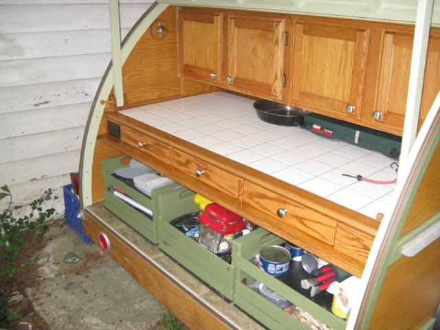

The original galley had some cloth/fiber drawers below the cabinet and storage crates below the drawers:

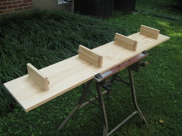

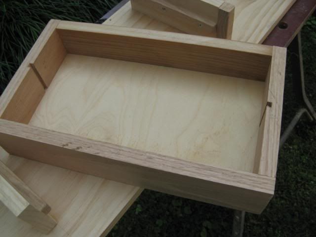

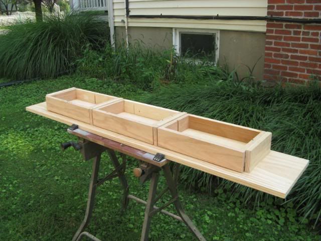

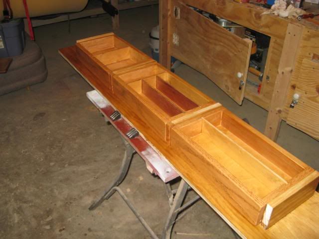

I am in the process making wooden drawers and underneath that, cabinets with one large drawer. The shelf that the original drawers sat on was screwed from underneath onto cleats at the back and sides. I removed it and used as a template to make a slightly deeper shelf to allow maximum depth for the lower cabinets. Once I had the new shelf, I took measurements and removed, then built the drawers on it in my workshop. When it was finished, the whole piece was screwed into place.
The drawers are 3 sided oak with pine backs. I used oak to match the upper cabinets, and so I could have a hardwood daddos for oak sliders that I screwed onto the drawer separators. I just figured out how to make daddos and I went a little crazy.

Postby Kharn » Thu Sep 22, 2011 3:05 pm
What's taking up the spaces to the left and right of the drawers?
Kharn
Posts: 655
Postby BillZ » Thu Sep 22, 2011 5:35 pm
Kharn wrote:What's taking up the spaces to the left and right of the drawers?
The left side is an electrical outlet. It's hard to see in the pic. I made a space on the right to keep things symmetrical. In the future I will make use of the space on the right but I want to keep a clean look on the front. Maybe an "invisible" drawer.

Postby BillZ » Wed Oct 05, 2011 7:56 am
Mikka wrote:Very nicely made. Just one question, I would like to know why you choosed wooden slides over metal? are you not afraid that with humidity the wood will expand and make it a challenge to open the drawers?
May be it's not an issue in your area, but up here it would certainly be one.
Just curious to see if besides varnish you specially treated the wood.
Wood runners was just personal preference. I thought it would fit better with the overall construction theme.
I didn't treat the runners or the daddos with anything but stain because I knew that poly or urethane would create more friction. I did wax the wood at points of contact and they slide very well. The drawer fronts are treated with spar urethane.
As far as swelling, I tried to leave enough wiggle room to allow for it but only time will tell. Our last camping trip was in the middle of record rain for the area and everything on the camper was swelling. The drawers still worked fine.
Verna wrote: Bill, for your drawer stop, how's about taking a small piece of oak, say 1/2" long by 1" long, about 1/4" to 1/2" thick, drilling a hole in the middle. Then screw it to the inside of the back of the drawer where it will catch the lip of the cabinet above, but you can turn it so it's out of the way when you want to take the entire drawer out. I can make a mock-up if I didn't explain it well enough.
There isn't more than a very fine lip under the counter. Maybe 1/16"-1/8"
I bought some plastic plumbing pipe hanging strip and will try to make tabs to attach to the back of the drawers. Hopefully they will catch enough to work as stops.
