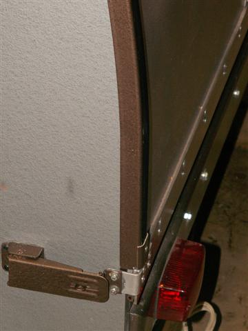

Postby Toytaco2 » Thu Sep 22, 2011 8:45 pm
Draw latches, similar to Mark's. I painted mine to match my molding.

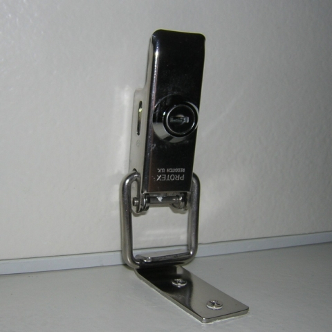

Made to work in almost any position, McMaster-Carr SS Draw Latches come with 4 different catches, displayed at their website. The latches can be keyed to match each other by a locksmith. My locksmith charged me $6 to do that.
http://www.mcmaster.com/#6139a26/=e6hv2a
Zinc version is also available and less expensive, #6139a23, listed at the same website, above.
They are secured with stainless steel screws and 3M 5200, which will rip the wood out before the screws will ever come loose or leak (fingers crossed). :roll:

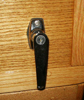

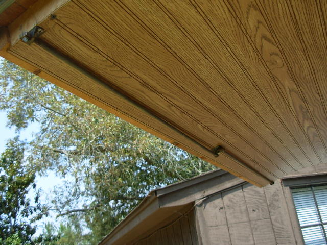

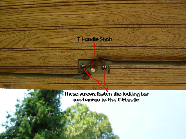

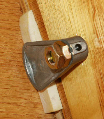

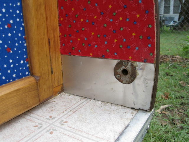

I used a 'T' handle/locking bar arrangement from an old pick-up camper shell (these can be bought from different sources) that I modified slightly to fit my hatch (shortened the locking bars). Used large 'fender' type washers to reinforce the bar receptacle holes in the side walls. Since my side walls are 'stick' built with framing, skins (inside & out), & insulation, there was plenty of 'depth' for the locking bar receptacles -
The locking 'T' handle from outside
Inside

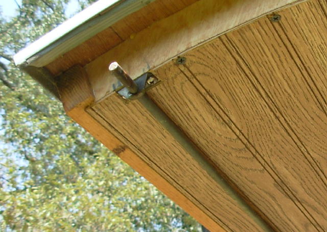

Locking bars extend at lease an inch into receptacles
The aluminum 'shields' around the receptacles have gotten 'beat-up- for various reasons. They're now epoxied in place (should've done that first)

Harvey, I like that! A pickup topper... cheap or free anywhere in the world.
