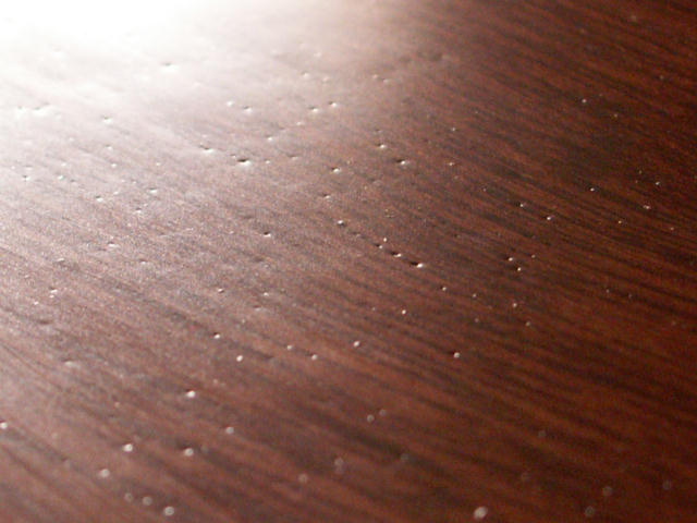

I'm not sure where I went wrong, but I've got pin-holes in my clear finish.
1. Applied the stain and let it dry for 2 days.
2. Applied the 1st coat of Minwax Helsman Semi-Gloss Spar Urethane with a brush and let it dry overnight.
3. Sanded with 220 grit. Wiped with a dry rag. Wiped with a tack cloth. Applied 2nd coat.
4. 3rd coat same as the 2nd.
Anyone have any ideas on what would cause this and if there is a way to fix it short of sanding it all off and starting over? This is driving me crazy. :? Thanks.

Did you shake the can, or stir it too fast? Sometimes air bubbles in the varnish will cause pin holes like that.

I guess it's possible, but I don't think I did. There pin-holes over every square inch of both sides.

Did you notice pinholes in the earlier coats? If so, I think it's probably brush bubbles, I had trouble with them when I used a foam brush with some urethane one time.
If it's just in the top coat, can you put on one more thin coat to fill the holes?

Found this: And on close-grain woods where no filler is used a first coat of varnish which is too thick will cause pin-holes to appear. The thick varnish fails to penetrate into the wood cells. The first coat of varnish should be thinned with about 25% of pure turpentine, for first coat only.
Looks like I should have thinned my spar urethane. Yes the holes are in all coats. Any ideas on how to fix it?

You will probably hate to hear this, but 3 or 4 coats may not be enough.
Every time you sand and re-coat, you are adding a very thin film to the surface that follows the surface of the previous coat. If that previous coat has any surface irregularities ( whether caused by dust, sweat, wax, solvent), they will show until they are flattened or filled. It might take six or eight coats, if you are lucky, to fill the deepest of those irregularities.
But take heart: from 6 or 8 feet, no one but you will be able to spot those irregularities unless the lighting conditions are right.. Or else, plan on more scraping, sanding and finishing.
No one, I repeat, no one (except me) will inspect your finish on an inch by square inch basis to look for defects.
The first trip will produce more defects and rock chips than the problems you are seeing. Stand back and inspect your work fom 10 feet with your eyes squinted and decide if you need to do more finish work.

I got some of the same issue when I applied the spar urethane to my exposed oak roof spars. Even got some bubbles. Sanded them away and kept applying coats. I think I did 4 coats and was satisfied.

You're right about the thinning. I use the Helmsman spar varnish on all my boat work. I usually do the first coat thinned 50/50. The second coat 25% thinner and subsequent coats (usually 2) full strength. I bought a couple empty paint cans at Home Depot and I keep the two thinned mixtures on hand all the time. I always get a beautiful finish with it. It is my preferred wood finish.

And I will ditto what others have said, thinning helps immensely. Depending on what finish I am trying to achieve, I will thin poly anywhere from 25-50%, and put on numerous thin coats.

If that was a paint job on an automobile, I would say solvent pop. Not enough time allowed for the previous coat to dry.
If you can still smell the varnish, it is not dry. Sanding it down, to give a surface for the next coat to "grip" actually will expose the inner surface that is not dry. It dries from the outside in, so you should allow time after your sanding before applying more varnish. Of course my thoughts, and others are easily tested on some scraps of wood, so that you know the correct way to get the end result you are looking for. If I were you, I would be experimenting and testing so you don't have more time spent, and more disappointment.
