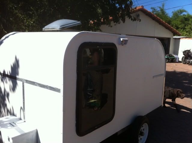

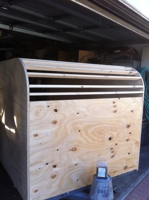

Postby Willowagon » Fri Oct 12, 2012 1:15 pm
I covered mine in Home Depot 4x8 FRP, glued straight to the spars & stapled the edges along the top of the sidewall, which are now hidden by the edge trim. The Home Depot FRP strong enough to attach without luan backer, why add extra steps, material & wieght? I insulated between spars w/sheet foam.
I then did a 400g light sanding of the entire traielr and went nuts with about 8 cans of Krylon Fusion UV Clearcoat. The HD FRP, $28 per 4x8 sheet, was about 1/2 the cost of Filon when I priced it. Csot about another 30-40 in krylon clear. I live in So Cal, have had the trailer in the sun all summer and no probs yet.
