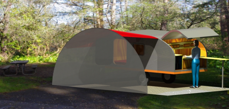

This was my idea that I was going to attempt to incorporate once I finish the trailer side of my build. Some fiberglass tent poles in a half moon hoop. Going to plan on having a flap door to come down to protect us from the bugs where we camp. I'll let you know how it turns out.

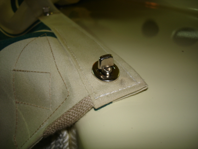

I've used these twist studs mounted on both sides of the tear for the awning. This way the awning mounts to either side of the trailer without a long track attached to the trailer body. Just an idea.

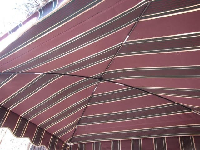

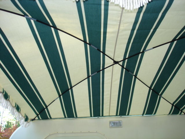

As a side note, if you put some pockets at each corner of the awning and a velcro tie in the center, you can modify some shock corded tent poles to support the top of the awning. It gives more head room, won't allow water to collect on it and will support itself without guy ropes to trip over, unless it's windy...then needs at least a weight to hold the awning on the poles. I had Marti make this one up and it's always been a great awning! Doug

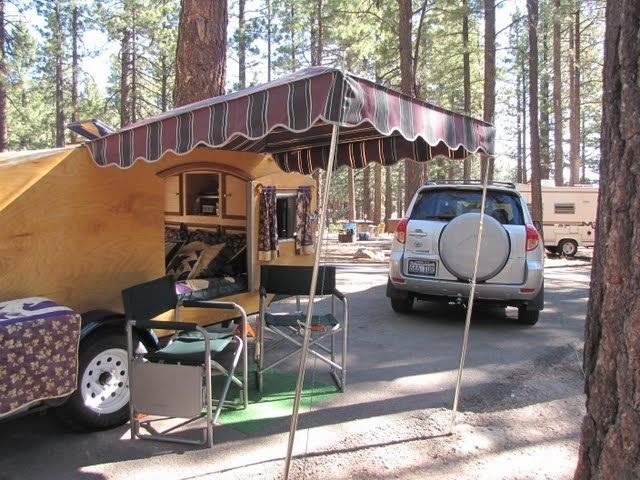

Postby nevadatear » Thu Jan 24, 2013 9:59 am
+ 1 for doug's idea. That is what i did from his suggestion and we love it!

I don't think that's the case, but thank you...I just get lucky once in a while. I wanted something that was more typical of a vintage type attachment. I've done the poles on awnings up to 7x7 so don't know just how large you can go with the tent pole thing. The larger you go, the more strength you are going to need at the pockets as the poles are going to need more bow to support the weight. Doug
