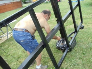

Postby campwithme » Mon Aug 26, 2013 10:16 pm
gallery/image.php?mode=thumbnail&album_id=2571&image_id=94714 does this help...I think I just need to move the front hanger up and inch...... :oops:
campwithme
Posts: 14
Images: 28
Joined: Thu Jan 26, 2012 9:39 pm
Location: wilmington Ill

Postby Kody » Mon Aug 26, 2013 11:47 pm
How many leaves are your springs made with? It's a bit hard to see in the photo. If you have four leaves, try removing one. This will take out the extreme bouncing immediately.

Re: bouncing
Postby campwithme » Tue Aug 27, 2013 1:19 am
ok there 1750 lbs. springs and I did remove the bottom spring.... I think there 5 springs

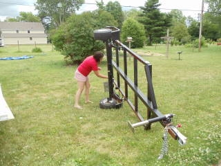

Re: bouncing
Postby campwithme » Tue Aug 27, 2013 1:35 am
I hope this pic helps... I think the bracket needs to be moves forward about and 1 in.....gallery/image.php?mode=thumbnail&album_id=2571&image_id=111604
