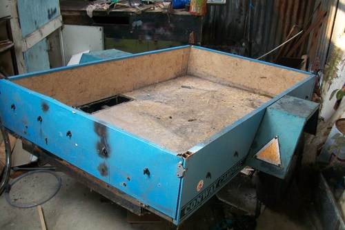

Postby cgill101 » Tue Sep 03, 2013 5:09 pm
So I started my teardrop in June and have made steady progress over the summer, making full use of your great forum for tips. I thought it was time to share some of my pics and get some input :D
The willing victim

Postby cgill101 » Tue Sep 03, 2013 5:43 pm
111864 stripping donor trailer down
111861 Ethan my eldest helping me clean up the rust
111865 After a lot of work getting back to raw metal and applying 3 coats of hammerite, trailer looked good, wheels and axles are being replaced

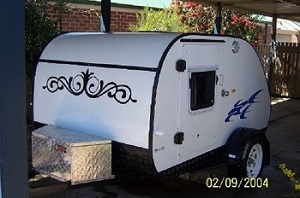

Postby Roo Dog » Tue Sep 03, 2013 8:46 pm
CG,
I note a lack of windows or are they yet to come.
What is the final exterior finish.
RD :)
100_1737 (800x533) (500x333).jpg (126.34 KiB) Viewed 703 times
Lets do a three sixty and get out of here !
Roo Dog
Posts: 461
Joined: Fri Mar 22, 2013 3:12 pm
Location: Esperance Western Australia
Re: First Teardrop: UK Durham
Postby cgill101 » Wed Sep 04, 2013 3:45 am
I plan on putting a window in on the front wall, framing is in but window hasn't arrived yet. Finish will be aluminium on roof/hath and ABS (plastic) UV rated in black for sides, wheel arches are at the shop being sprayed candy red.

Postby Roo Dog » Thu Sep 05, 2013 6:47 am
CG,
Just for interest the Tear in the picture is clad with prepainted steel glued to the ply.
The steel and paint has a guarantee of 15 years against corrosion and paint peeling.
Take it easy.
RD :)
