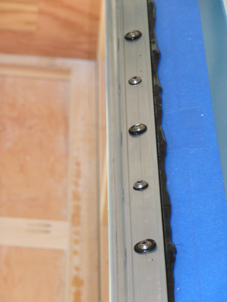

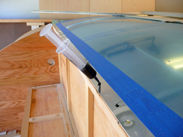

I used the "less permanent" 3M 4200. It is removable but just barely.
I used a two-part method for attaching my trim and skin. First, I temporarily attached trim & skin using regular Kreg screws but no 3M 4200. After attached, I replaced each one screw-by-screw with SS Kreg screws and injected 3M 4200 as I went along.

I have...delicately...removed a few stainless steel screws with the 3M 4200 but did "snap" one in the process. Both the 4200 and 5200 are designed for below the waterline use. I think 5200 will work but depending upon how much you use and how long your fasteners are, you may not be able to remove them if you need to some day.
I love the 3M products, but in the "if I were to do it again" scenario, OSI gutter sealant will work just as well, is significantly less expensive, and is available at most the orange and blue big box stores.
