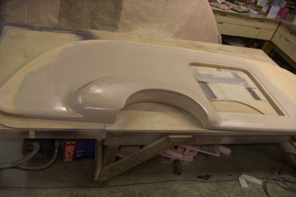

heres what I'm doing with foam board,epoxyand fiberglass. fender is all carved pink foam then glued to the side with epoxy. the whole thing is covered with biaxial mat, 2 layers of glass and epoxy. then its sanded ,filled with bodyfiller and primed.

Postby Chris C » Sun May 28, 2006 7:07 am
WOW! Gaston, I'm really impressed. That ought to really look great when you get it finished. 8)
WHEW! The talents some people have! :o
