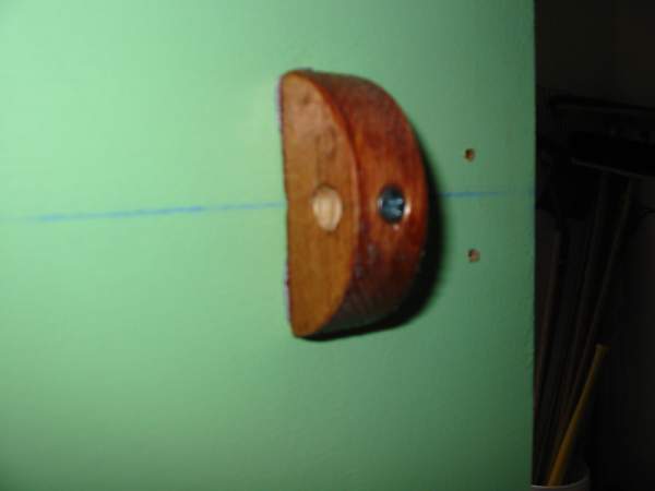

I started a little project today to finish off the tear. The pictures at the top of page 11 are the start..... anyone care to guess what they are going to be?
The only clues will be the existing pix and the ones I add as time goes on.

Postby Arne » Thu Jul 31, 2008 7:33 am
Added one pic to bottom of paragraph on pg 11.....

Postby Arne » Thu Jul 31, 2008 1:40 pm
I mounted the pieces on a piece of scrap ply to stain them. The are spaced up off the ply with washers.
4 have 5/16" holes drilled into the side. 4 have 23/64" holes drilled into the side. They are not drilled completely through.
The 9/64" holes drilled into the curved face are through holes.
Pictures in same paragraph at end.

Postby 01Sport » Fri Aug 01, 2008 11:09 am
Arne wrote:I mounted the pieces on a piece of scrap ply to stain them. The are spaced up off the ply with washers.
I'm looking and have no clue. :thinking:

Postby Arne » Fri Aug 01, 2008 1:17 pm
Bruce, yes. Am mounting the spare right now, the mattress is back out on the ground so I can drill the carriage bolts through. The basic galley is done as far as we want it now, will determine where to go with it after we use it a couple of times.
K.C... I understand what you mean. It will all become clear in a day or two.... I have mounted all those semi-circular blocks..... and after the glue dries, the final step will be done... will post another pic or two later today after I'm finished working on it....
