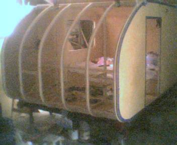

Postby Miriam C. » Fri Nov 03, 2006 1:26 pm
Success!!!!
The fix on the hatch worked and now if I can get some room I can do the rest of the framing and skinning. 8) I went on to the cabinetts to keep from taking an axe to the hatch. :? but it is back.
Having trouble getting a good picture with the sun in the South. You can see the edge of the hatch now and just the right size for a seal. :D
