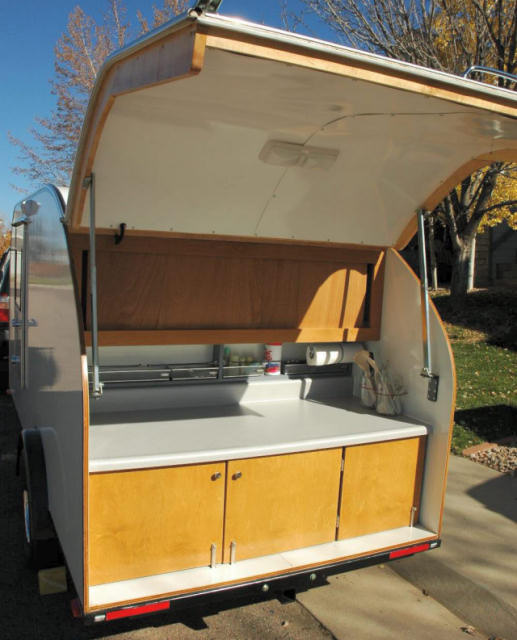

Postby Gerdo » Thu Nov 02, 2006 1:10 pm
My hatch ribs are about 3/16" inset from each side. I do want to do the screw centering idea but I beveled the top edge of my ribs so if it got off center it would ramp inside instead of catching causing damage.
I also set my hatch props high so I would not hit my head on the edge when lifted even if it is tail down.
