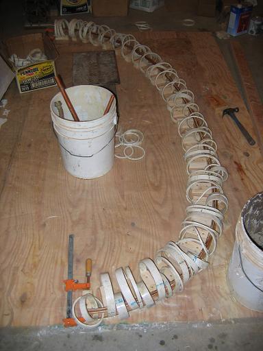

I am guessing you are conderned about screwing the roof on. That is the only place other than the floor where you are going to get the end. For the roof you can cut the OSB smaller than the outside and laminate strips of wood around it to form a frame that is wood.
JP did his on a jig but your OSB can act as a jig.
The other way would be to Kerf to make a frame aroung the OSB.
Both these will work but I think the laminating will be easier and faster given the debth needed. You can also put some glue on the screws to help. Some people didn't screw their roof down and some removed the screws after the epoxy dried. Don't know about glue without screws or nails.

My steps would be: 1) cut profile from OSB (which I will do no matter what framing option I use). 2) use the perfected profile to cut three more just like it (probably with the router?) I would cut them seperatly to avoid any issues with the jig saw blade drifting. 3)cut out door and unwated OSB to create frame (I would probably leave no less that 4 inches of OSB between cut outs). 4) clamp the template to each profile and use the router to duplicate the cutouts. 5) glue the profiles together. 6)laminate 1/8 strips to the top of the frames.

You know I don't think anyone but maybe Andrew or Mike Sch. can begin to tell you if you are weight efficient. I would cut strips less than 1/4 to make it easy to laminate. Maybe 3 one eighth inch strips. It will take time to set the glue. YOu can probably glue a strip every hour but need to give it 24 hours to set up before you put stress on it.
I framed mine because it looked easier. For me it was. I didn't want to lift a bunch of weight. I made this with kerfing and screws. I cut my own framing sticks out of 2x6's.

I didn't do it that way, but I think the slickest systems are the ones, like Mike seems to prefer, where you glue up the curved section of the frame, then frame inside that with solid wood.
That would make it possible to make the wall thickness anything you might like. Foam insulation varies in thickness.

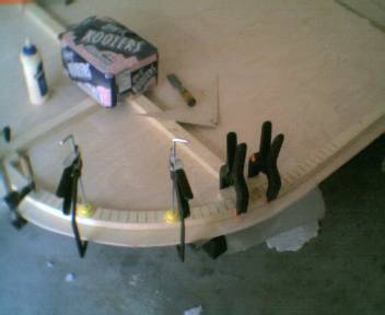

Postby Miriam C. » Tue Jan 09, 2007 2:01 pm
The roof won't actually touch the end-grain if you use a laminated edgeframe. Tying the frame to the rest of the camper might be an issue.
Perhaps if you put a 1x2 at the bottom. Kinda wrap the OSB in a wood edge so it is secure and glue the whole thing to both sides. Might need to make the laminate thicker so there is a larger side to glue to the sides. Maybe Andrew or one of the real experienced builders can jump in.
Or you could find out how JP tied his in. 8)
New stuff. Duh
What you can't see very well in this picture is the ceiling is glued and laying on the kerfed frame. The spars are glued and screw at the ends, and glued to the ceiling. There is blocking all along the edge that is glued and screwed to the top and sides. The roof is then glued and screwed to the spars and the blocking. I left the screws in.
