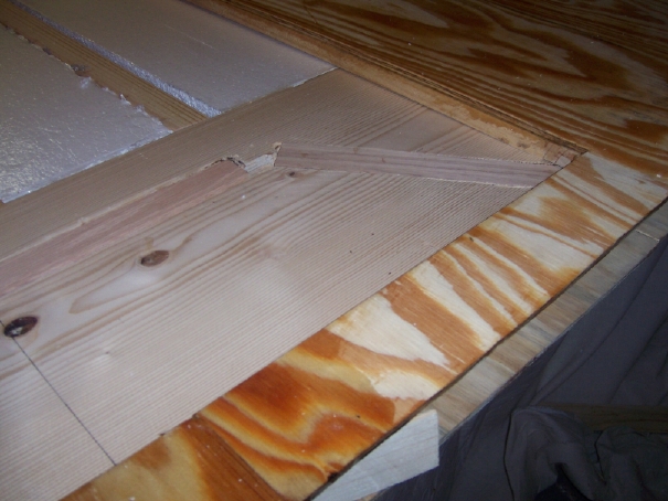

Postby Lynn Coleman » Tue Feb 20, 2007 11:33 pm
Hi all,
Well we used the spine idea (Thanks Danny), gorilla glue for the width of the blade cut (thanks all) and Titebond III for the rest of the glueing. I've heard it said that we over build on our first trailer, we'll that may be but I'm still concerned with the idea of it falling apart the first time we take it down the highway, so, we'll overbuild, I hope. 8)
The repair is done now we have to polish it up and finish it off. Below is a pic of a corner of the repair. It is the bottom wall and the other wall is sitting on top of it in this pic. Image
I'm sorry I forgot to take a picture of the actual repair but we need extra sets of hands to move these walls and I didn't think to get the camera first.
