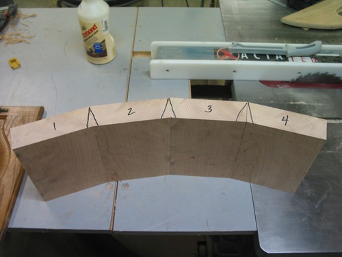

this is how they did the bend. Not quite as sharp.

thanks for the pics Miriam. Similar but different. We're thinking in terms of a solid 1/4 of a circle. It is the same as the ones in the side walls already. Below is a pic were you can make the 1/4 circle 3/4 ply out in the lower corner of the pic. I hope.
Lynn

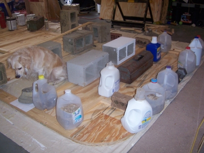

DHAZARD wrote:Interesting clamp, that must be a well trained dog to stay until the glue dries.
