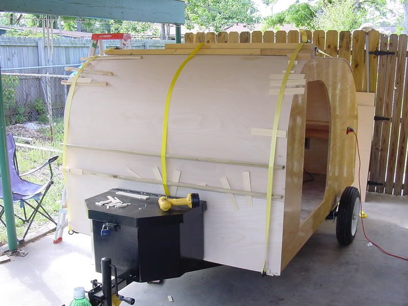

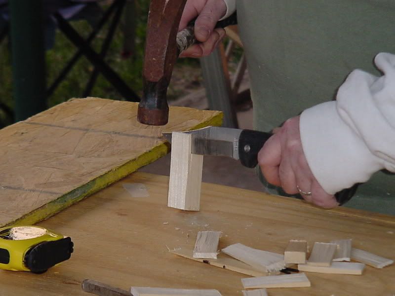

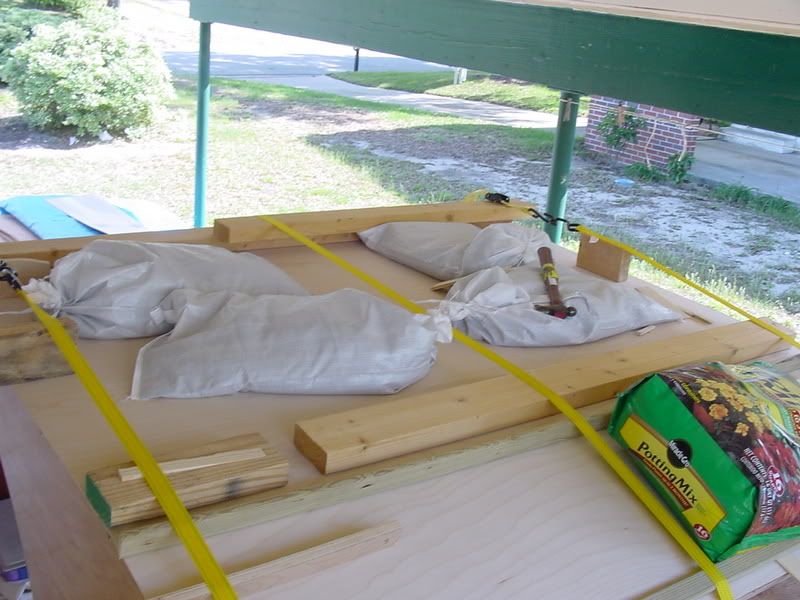

Postby Mary K » Wed Apr 11, 2007 11:49 am
Here are a few pics of the skinning
Use what ya got I guess. Like the potting soil bag. :Oh Brother: :lol:
Mk
Oh and Dad taught me how to make my own shims :thumbsup:

Postby b.bodemer » Wed Apr 11, 2007 12:08 pm
gotta love those straps!!!!!!!!!!!!!!!!! :thumbsup: :thumbsup:
Lookin' good MK! :applause: :applause:

Postby Miriam C. » Wed Apr 11, 2007 12:55 pm
ImageGood job Mary k. I see you got the gravity thing working for you again. :thumbsup:
Little bit at a time. ;)

Postby Mary K » Wed Apr 11, 2007 8:03 pm
Thanks Barb, Auntie M & Kerry!
We attemped to skin the hatch today and on our dry run (without glue), we found it isn't going to be as easy.
We need more sandbags. :Oh Brother: And forget the straps.
Mk
