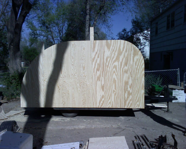

I had a very productive weekend I think. The walls are slowing me down a bit because I am having to think about where everything goes but, they are moving along. What do you think about the profile? the side wall is 10ft long and 5 ft high from the top of the deck.
I am still trying to decide how I want to do the sidewall framing, i will use 3/4 pine as the material, but should i stop it 1 1/2" from the top of outside ply to allow for the spars to sit on top of the wall frame? or should I frame up to the top and have the spares between the frame on each side? i have seen several different ways of doing this. any help would be appreciated.

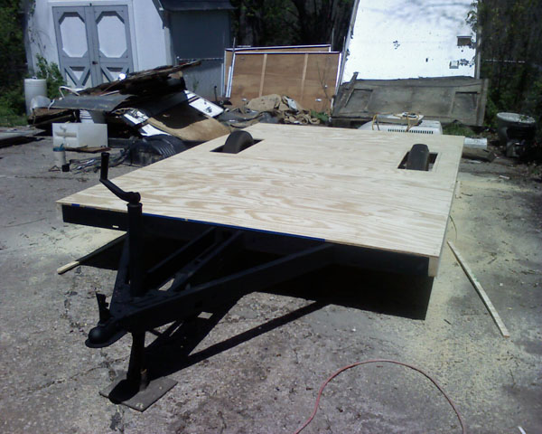

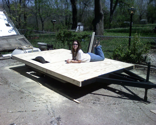

I got the floor put on.

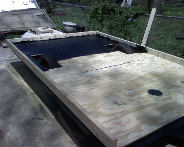

After building the floor I removed the bolts and flipped the whole thing over to put the tar on.

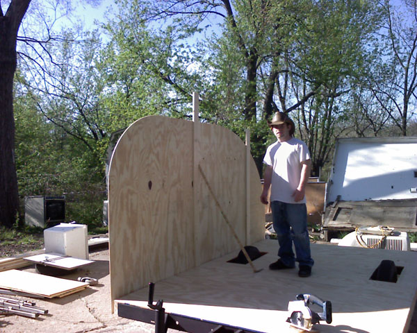

I cut out my sidewall profile and started laying out where everything will go.
Here is a dry fit of the sidewall profile to see what it will look like, I am so excited.
Here is another pic of the dry fit sidewall, I am only 5'2 and I will still crouch in my 5' tear, but it will be huge for me compared to a normal tear.

Framing - I'm planning on stopping it 1-5/8" below to allow for 1/8" inside skin and still have full 1-1/2" for insulation and ribs/spars. Many people on this forum talk about framing/insulating/skinning/painting walls while flat and horizontal, which implies that one has to know where lights, switches etc. have to be. Wired in, not installed yet, of course.
