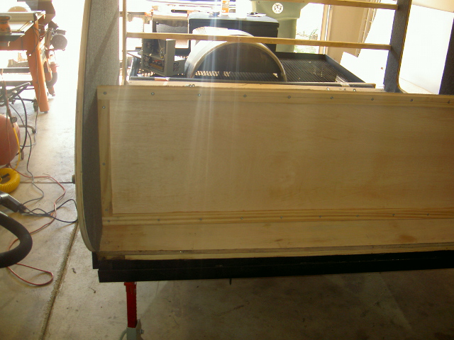

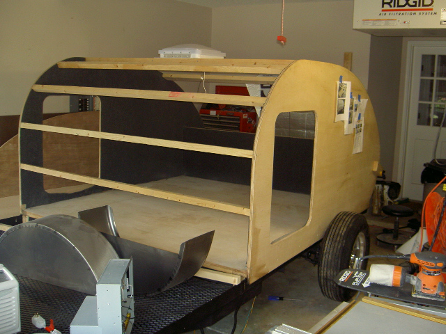

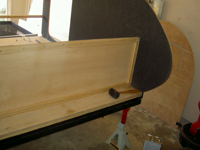

A nice shot of the front showing the Lower Bulkhead Installed and also test fitting the roof vent.
Ok, now a side profile...Say Cheese!!!

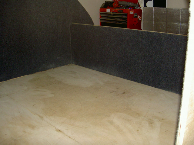

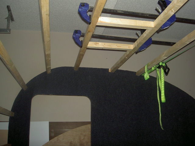

Leaning in through the doorway, I got an interior shot of the newly installed Lower Bulkhead which is 20 1/8" tall. Since I have no plans, the height just sounded good so therefore that's why it's 20 1/8".

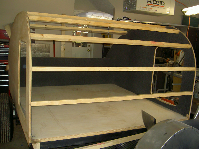

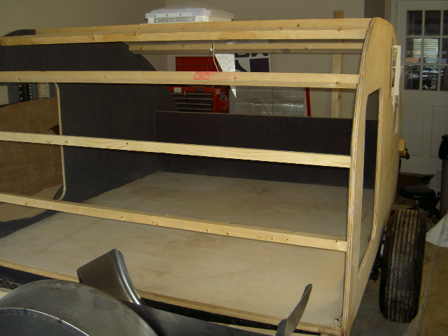

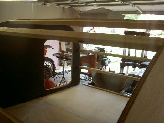

Yesterday I installed the lower hatch roof spar. I had no clue where to put it but since I am building minute by minute, I decided to space the lower hatch spar 36" from the back of the roof spar where the hatch hinges will go.
After I let the main lower hatch spar cure overnight under clamping pressure, I came back today and installed the next roof spar 8" lower than the main hatch spar. Why there, I have no clue. I am still building blind with no plans to speak of. Between this spar and the hatch spar, the taillights will be installed....I hope.

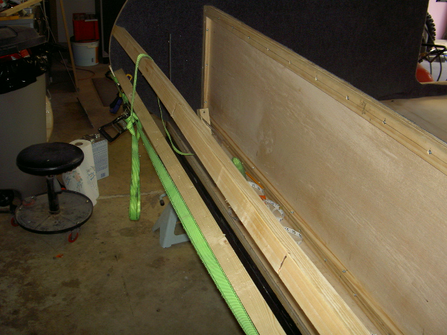

A shot of the upper hatch spar which is a full 2x4 for strength and to give the hatch hinges something to bit into.

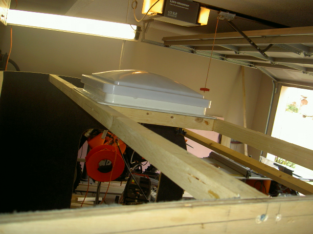

Here's a shot of the roof with the test fitting of the roof vent. It fits in there nicely with a little wiggle room to center it.
