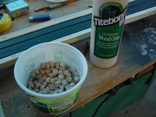

Postby Mary K » Tue Aug 07, 2007 11:20 am
Here ya go Heikki. Here is a start for the pictures.
I just purchased some wood plugs..it was easier. :oops:
Mk

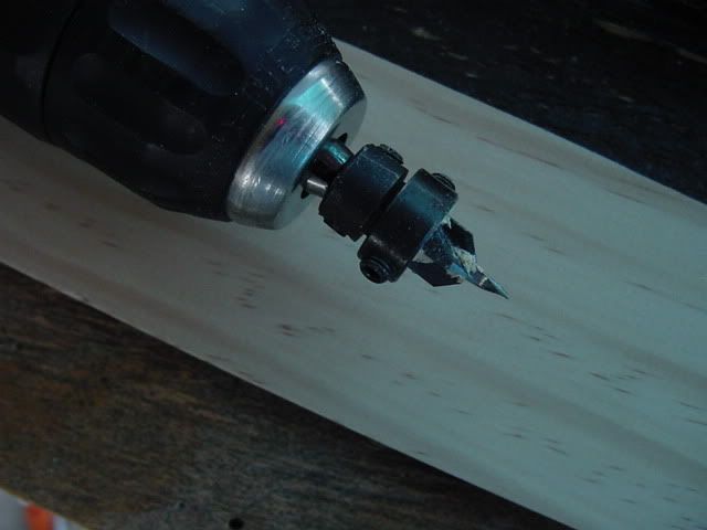

Postby Classic Finn » Tue Aug 07, 2007 5:28 pm
Mary K wrote:Here ya go Heikki. Here is a start for the pictures.
Mk
Great pics there Mary K... You mean ta tell me now dat ya really bought some of dem dar plugs instead of makin them? :roll: :roll: :roll: :roll:
Ya shure has a big ol bucket full of em... :lol: :lol: :lol: Now where ya gonna put em all? :thinking: :thinking: :thinking:
Yup I found a bunch of them also premade.. even though havent purchased them as of yet.. ;)
Is that there funny looking bit or blade on a normal electric screwdriver?
What is that funny looking blade for anywho? For making dem thar holes for them dar store bought plugs? :D :D
Classic Finn :thumbsup:

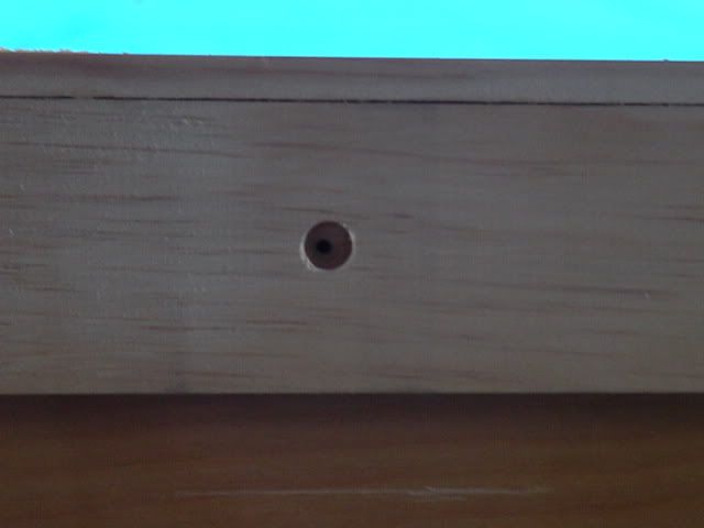

Postby Mary K » Tue Aug 07, 2007 10:15 pm
Classic Finn wrote:Great pics there Mary K... You mean ta tell me now dat ya really bought some of dem dar plugs instead of makin them? :roll: :roll: :roll: :roll:
Dagon Heikki, yor writin redneck acksent is gud!!! :thumbsup: :applause:
:lol: :lol: Ya know Heikki, it was just easier to buy them then to make them. :oops: I figure I have 260 holes to plug and there is about 220 in that "bucket". 2 bag short, figures huh?
That bit is in a Dewalt 9.5 cordless drill. The bit is a counter sink bit I purchased as a set at HF
Of course being the brut that I am, I broke the bit and had to shove the countersnk thingie close to the end. :oops:
And Yes, it makes the holes for the plugs. :thumbsup:
Mk

Postby Podunkfla » Tue Aug 07, 2007 10:23 pm
Wow MK... You got the system going on with the plugs! :thumbsup:
That countersink bit does a nice clean job of it too. Congrats.
I like that hinge too. Just makes for a neat smooth install. :applause:
