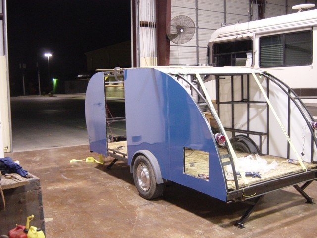

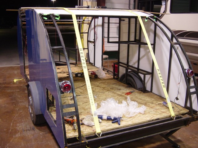

finally have some updated pictures
Postby Sonetpro » Thu Aug 09, 2007 5:14 am
:thumbsup: :thumbsup:
Look's like it's coming along nicely. I can't wait to see it skinned.

Postby jagular7 » Thu Aug 09, 2007 4:06 pm
Before you skin the outside, you may want to skin the inside, cut you electrical switches, etc out, run/secure the wires, and insulate. Then enclose it all from the outside. Being that big of a trailer with limited width, you would probably have a slight problem getting material through the doors or windows to finish the inside.
Mike
Jagular
Lenexa, KS
jagular7
Posts: 409
Joined: Tue Mar 21, 2006 5:10 pm
Postby Big DE » Fri Aug 10, 2007 8:00 am
Jaguar,
I thought about doing it in that order but under my carport isnt the dryest place in town, so I have to put the skin on and dry it in some what before I can start on the inside. I can bring all the material in from the back. As a matter of fact I'm not putting the floor in until I get it skinned. :crazy:
Thanks, Big De

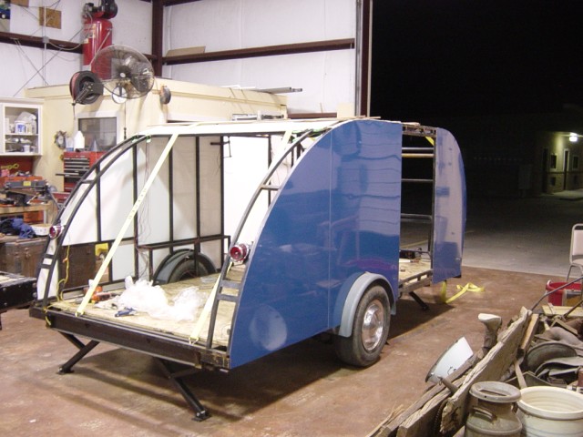

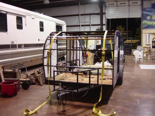

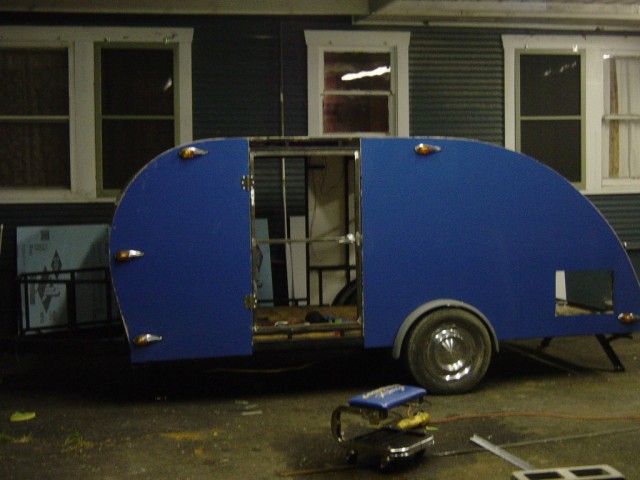

Postby Big DE » Wed Aug 22, 2007 9:37 am
Here are a few updated pictures I should have it done tonight aside from a few small pieces :worship:
hopefully the doors wont be a problem :thinking:
Thanks Big DE
Big DE
Posts: 201
Images: 93
Joined: Thu Aug 31, 2006 3:10 pm
Location: MANVEL,TX
Postby tonyj » Wed Aug 22, 2007 9:47 am
Of course the doors will be a problem, but you have the skills to overcome! Looking very nice.

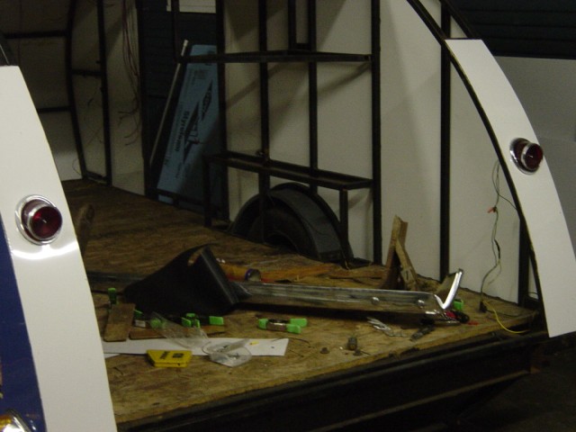

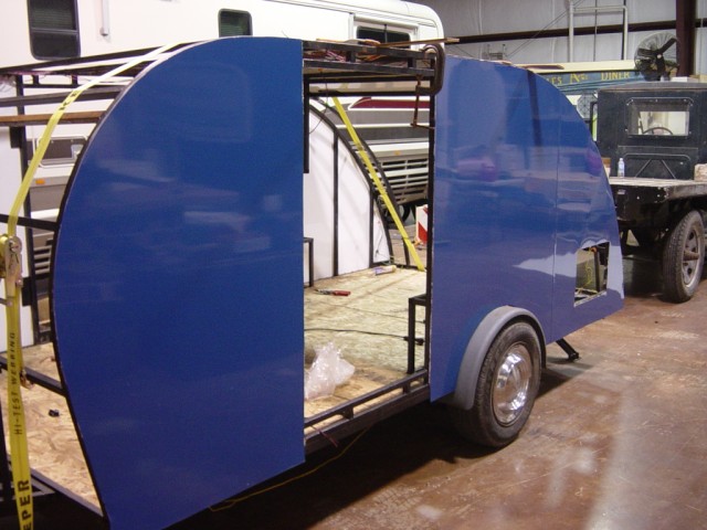

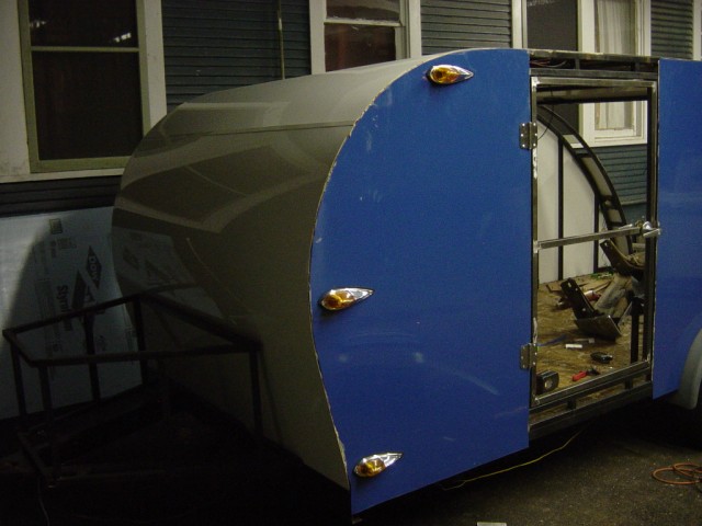

Postby Big DE » Tue Sep 11, 2007 10:49 am
We are getting a little closer to bieng road ready :twisted:
door frame
side profile of running lights
65 impala tail lights
I used a bead roller for the seams
comic relief / tennis ball handler
mystery of missing tennis ball fuzz solved :lol:
My wife and I cant wait till the LCG II hopefully ill have it closed in or we will be sleepin without doors
BigDE :thumbdown:

Postby madprinter » Sat Mar 01, 2008 1:29 am
Great looking Camper :thumbsup:
You're building just what I had in mind except I plan to go 6'6" x12 and 5' high. What size tubing do you have in the walls 1"??? How did you connect the metal siding , with screws or rivits?? And one last question, is that steel or aluminuim sheet metal? Please keep the pics and info on your build coming. :applause: :applause:

Postby Big DE » Sun Mar 02, 2008 9:21 pm
MP,
Im using 1x1 thin wall tube and I went an bought a tube of automotive glue that was rather expensive $35.00 and it has a self mixing tip on it. Well I couldnt squeeze hard enough to make that glue come out with any consistancy. So I went and bought several tubes of construction grade liquid nail :thinking: and it is holding it so far but I havnt put many miles on it, so if anyone is driving around south east texas and you see some blue sheet metal pick it up for me I will pay for shipping lol :lol: :lol:
