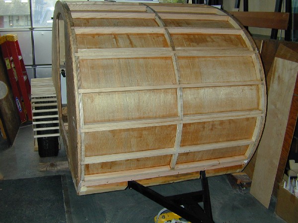

Postby Dean in Eureka, CA » Mon Sep 10, 2007 9:20 pm
Jim,
It's spendy maple... I could've bought several sheets of luan for what I paid for one sheet of maple.
Don't know if you can tell from the pic what I did to correct it.
I glued 3/4" x 1 1/2" oak on top of it, with the interior blocking still in place.
I was able to get enough pressure on the break to get the ply back in shape.
What's nice is... I needed to put blocking there anyway for an interior shelf.
Kinda got lucky that the worm hole was where it was... :phew:

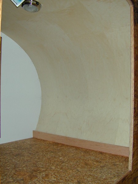

Postby Dean in Eureka, CA » Thu Sep 13, 2007 12:05 am
It only took five days to install the 4 x 8 ceiling...
The maple looks real good and I'm really surprised that I was able to get the amount of bend in it without it exploding...
