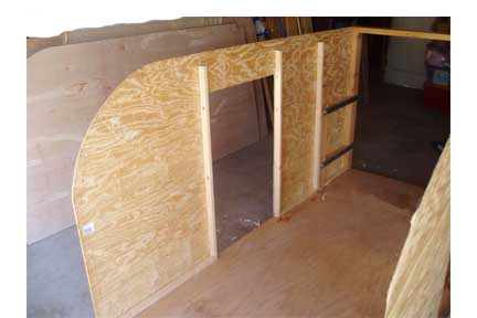

Postby Ron Dickey » Tue May 06, 2008 12:13 pm
for starts
when I built the walls I attached wood to add insolation between the walls to keep the weight down I used soft light pine as seen above.
When the wind ripped my door off in an attempt to put the doors on so I could camp with other trailers at a meet that night. The Pine did not hold the door. I added a second pc of the same wood strip where the hinge went and put in deeper screws.
Sould I either take that wood out and replace it with hard wood or put in a metel plate to reinforce it.

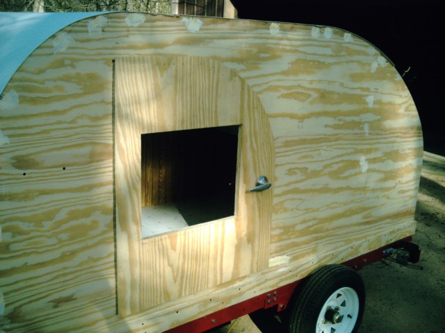

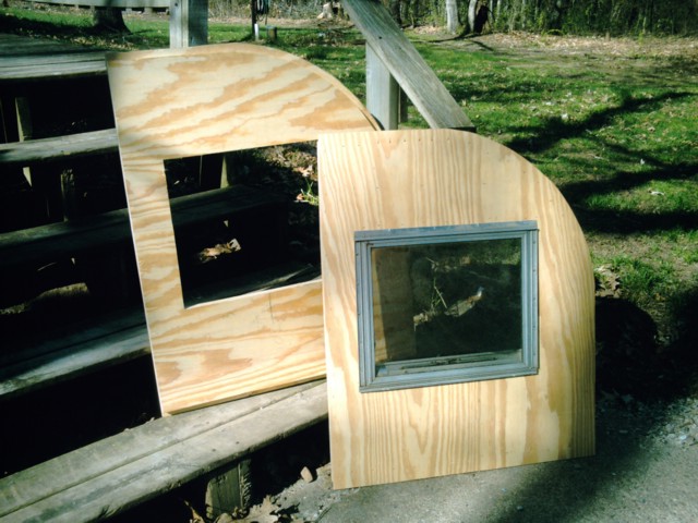

The finished door as you cans see from this shot
is not from the original batch of wood and I will later get closer to show you the flaws.
the first of which this door that you see is made of 2 pcs and I cut the window out at that point and put in the outside gun turit type window to hold it to gether.
The finished product looks good from a far. but it makes a door on an old shack look good, once you get closer. It is almost a gate rather then a door.

Postby MrBuzz » Tue May 06, 2008 1:27 pm
My doors were pretty simple.
I took the blank that I cut out of the side (3/4" plywood),
then glued that to a piece of 1/4" plywood that I cut 1" larger than the original. That over-lapping section of 1/4" is what seals the door. Oh, and the front of the door does not have the over-hanging 1/4"...that's where the hinge goes.
I used wood glue and lots of nail-gun staples to make sure the two pieces do not come loose.
Then cut the window and added a block so I could save some $$$ and use a standard house door handle assembly.

Postby Ron Dickey » Thu Jan 22, 2009 12:10 am
Same doors but I reinfoced the locks and took it off to NM in Aug of 08 a 3000 mile trip about.
Now that I understand doors better having seen many many doors and seeing Steve B.'s as he constructs his.
I have the wood for the new outside and in.
I did not think about that when I built the frame in the walls which are made of soft pine. I had to add hard wood to that to make the doors stay on.
Now I must figure that out all over again.
I might attach the hinges to the ouside oak wood or put in some strips of iron over the soft pine and bolt it on.
as you can see to the left... I have windows for them. I also now have door handles ready to install on the new doors.
Steve B. said he would help and he needs help in return. a Win Win thing.
I am still not good at posting pixs but I will try.
Ron D.

I planned ahead and used oak at both sides of the hinges and a block of oak where the latch was installed. For what it's worth, I wanted a retro look and have used a replica skeleton key deadbolt and knob combination. The outside knob is brass and the inside is clear plastic made to look like glass. As long as I lock the deadbolt before taking off, I have never had the doors come open.
