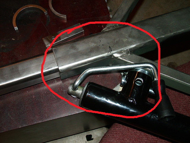

A vertical pin will weaken the tongue more than a horizontal pin will.
But you can get around this by putting the pin to the back of the 'receiver', where the stresses are low. Back there it is mostly the sides of the tongue doing the work so the vertical hole will have no effect.
Of course putting the pin at the back might not free up as much space for your jack as you want - but you could consider having the pin behind the jack.

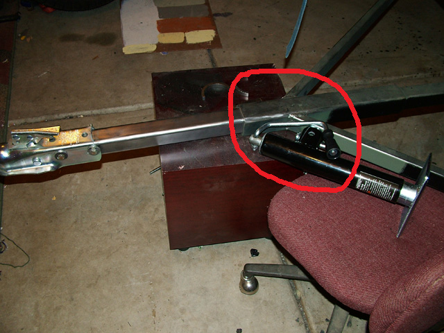

New Pics, Hopefully better visual representation of issue
Postby oregonguy » Mon Nov 10, 2008 8:20 pm
Maybe these two pics will clear up the issue for people. You can see where the clearance issue is a bit tight for where the hitch pin would normally go, hence the vertical idea. Whichever place I put the pin, it needs to go towards the front of the receiver section so that I can extend the tongue length on demand whenever needed.

Postby Tx River Rat » Mon Nov 10, 2008 8:42 pm
Oreganguy
You really don't have a problem at all, sliding one tube inside another
will increase your strength so much that drilling a hole vertically is of no concern
I hate to do this and I am not trying to start a argument ,but I disagree with a couple statements on here ,the top and bottom web of an I beam do two things , the bottom holds tension the top holds compression and they both stop twisting (there main Job) the taller the center web the stronger the beam.
In tubing it is the same. I am building my frame from 2 by 3 rectangular tubing If I lay it down 3 inches wide and 2 inches tall it is much weaker than the way I am going to run it 2 inches wide 3 inches tall, even though I have much more metal on top and bottom with the tubing laid the first way.

Postby angib » Tue Nov 11, 2008 5:34 am
If anyone wants the numbers:
- a 2"x2" tube with a 1/2" horizontal hole (ie, through both sides) loses 0.1% of its vertical bending strength;
- a 2"x2" tube with a 1/2" vertical hole (ie, through top and bottom) loses 21% of its vertical bending strength.
Of course the same numbers apply the other way round for horizontal bending strength, but I'm not aware of any tongue collapsing horizontally - it always seems to be vertical bending that's the killer.
Broadly speaking, a vertical hole through the tongue anywhere in front of the diagonal braces will lose a significant amount of strength. I believe you would not suffer much loss of strength if you put a vertical hole behind the diagonal braces, as that far back there isn't much bending load left on the removable piece of tongue.

After seeing the above photos, I’m inclined to drill the hole. I cannot foresee any flexing at that point that would lead to structural failure
1. There are two thickness of metals of two square tubes, The receiver hitch that I have is the same thickness and does quite well even with a sloppy tolerance.
2. The removable part extends well into cavity of the other – the fulcrum point will be at either end of the mating tubes – not at the drill site
3. The angle braces are close enough to the drill site to prevent cracking and bend out. That is where pin needs to go

I had not realized that only the portion which is forward of the diagonal braces that telescopes and is removable; it's not really the whole tongue which is removed (as is common with pole-tongue utility trailers). It looks like a good setup providing both adjustment of tongue length and perhaps more compact storage, very similar to the telescoping setup on the Oliver Legacy travel trailer.
