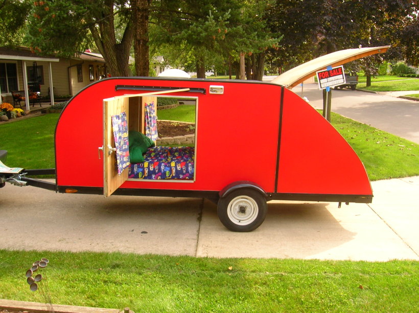

Postby Boodro » Tue Dec 09, 2008 3:51 pm
RED? You mean like this? :lol: :lol:
Yea I did! 8) 8)

Postby fseider » Wed Dec 10, 2008 12:07 am
Mark - you said that's rolled, and not sprayed? Wow! very nice! Mind if I ask what paint and roller brand you used? I'm looking to roll my roof but was concerned on the quality. Looks like you solved that problem.

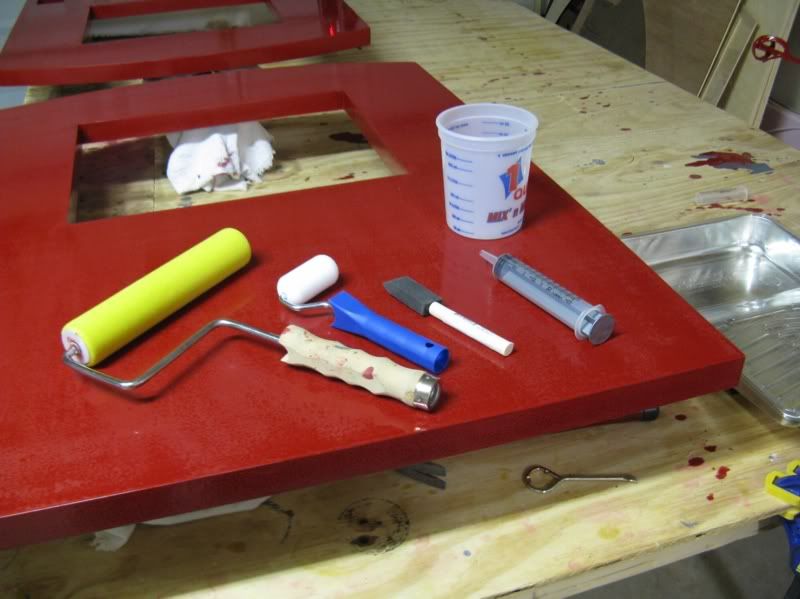

Postby planovet » Wed Dec 10, 2008 10:10 am
fseider wrote:Mark - you said that's rolled, and not sprayed? Wow! very nice! Mind if I ask what paint and roller brand you used? I'm looking to roll my roof but was concerned on the quality. Looks like you solved that problem.
I decided to roll instead of spray because I have never sprayed before. After reading about the learning curve with spraying I decided to roll. I didn't have a decent place to put up a paint room either. And then I came across an article where a guy painted his Corvair with Rustoleum paint and foam rollers for $50. (Link) That convinced me to roll my teardrop. I used Valspar Supreme Acrylic Enamel for the paint. I wanted to match the color of my trailer and that is the paint they used. I used 3 coats of primer and 5 coats of the top coat. After mixing in the hardener I reduced the enamel about 33% (recommended was 20-25%). This made the paint a little thinner and made it flow better. I used 1/8" nap foam rollers to apply the paint. I also used a 2" foam trim roller for the edges. I got the 1/8" nap foam rollers from West Marine and Jamestown Distributors. Jamestown has the cheaper prices, $4.47 for a pack of 2. (Link) Close up you can tell it is rolled but I think it still looks good. I haven't polished and waxed it yet so I anticipate it looking even better. (on the picture below the door has been wet sanded and waiting for the final topcoat, that is why it looks hazy)

Postby fseider » Wed Dec 10, 2008 10:23 am
Thanks Mark for those details on the paint technique. Very helpful, and I think I'l do exactly that for my roof. (The aluminum approach started to scare me and I was really looking to paint in the first place.)
