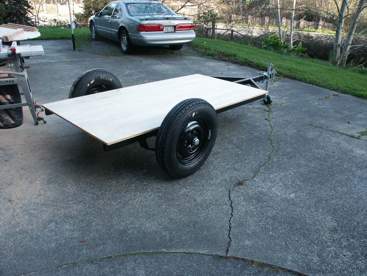

I mounted my 3/4" plywood deck directly to the steel frame using this type of screw http://www.acehardware.com/product/index.jsp?productId=1340626 It worked out really well, just use a powered driver to run the screws in. They drill, ream & tap their way through the plywood & steel frame rail. Here's the frame with the plywood installed.

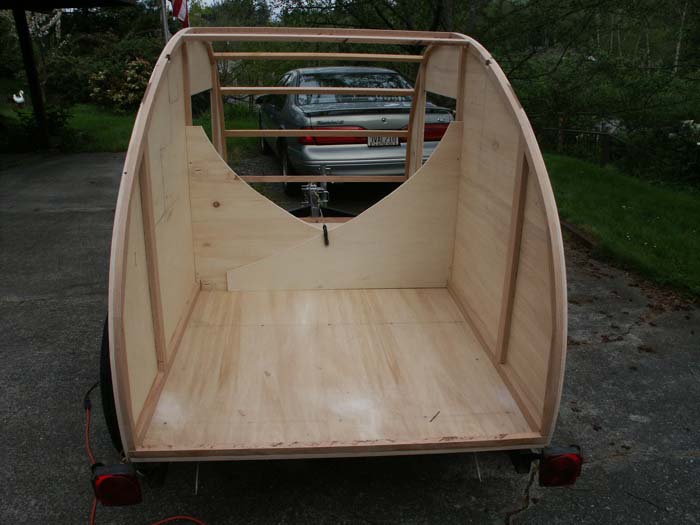

This view shows how I have the walls fastened to the floor. only the plywood wall is hanging outside the floor, the wall framing is supported on top of the floor.

Postby The R/C Man » Wed Apr 20, 2005 1:42 am
:o Those screws are pricey..... Looks good though. Did you put some kind of sealer on the bottom to protect it from the elements?

R/C,
I didn't bend the wood for the perimeter framing of the walls, I used 11 seperate pieces of 3/4" x 1 1/2" of varying lengths per wall. Each of these were cut on the end at an angle that matched the previous piece and also followed the contour of the wall's profile, once I had them all cut and clamped to the wall I marked each piece following the curve of the profile, next all the pieces were removed and I cut the excess off with my band saw, next step was to lay them all out on the wall again and glue & screw each piece to the wall. Once I had both walls to this point I clamped the two walls in a vertical fixture and used a belt sander to match the contour of both walls. It was lots of work to do it this way and I'm sure steam bending the oak is likely a better method, but I have no experience with steam bending wood. I used my table saw, band saw & lots of patience
8)
Mike,
Here's one side view of a wall, I posted a few more in my album.
